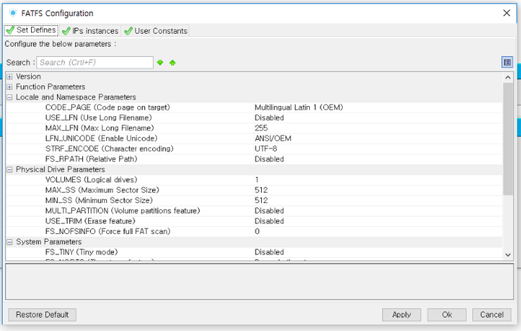

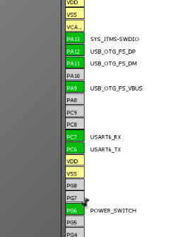

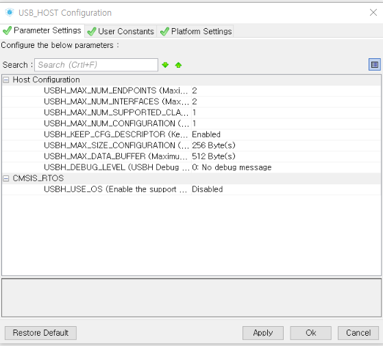

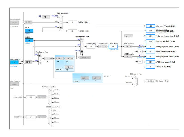

The sample is usb-detectable without any problem, and the txt file can be written well.If you design code with cube as below, you can not detect usb.

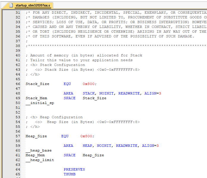

If you create a project with cube, you have to change heap / stack size.
Appli_State value should be recognized as 1, even if you connect usb stick, it is still 0;
I need to solve the problem, but I do not have enough time.
