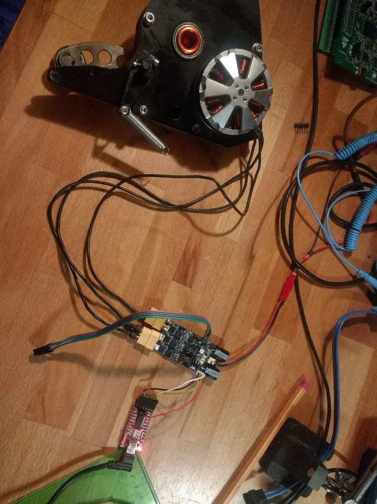

After a view short tests with the ST Motor Profiler the Rotor seemed to stall.
(Lab-powersupply 22V 9A)
Then smoke appeared (not sure where exactly)

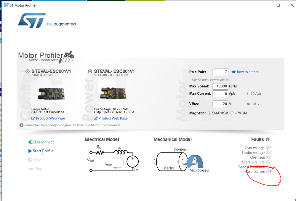

Now every time i want so start the Profiler it says "Over current".
Even when i set the maximum current to 0.070 mA or unplug the motor.
What has happened ? Have i made an error ?
Is there a work around ?
