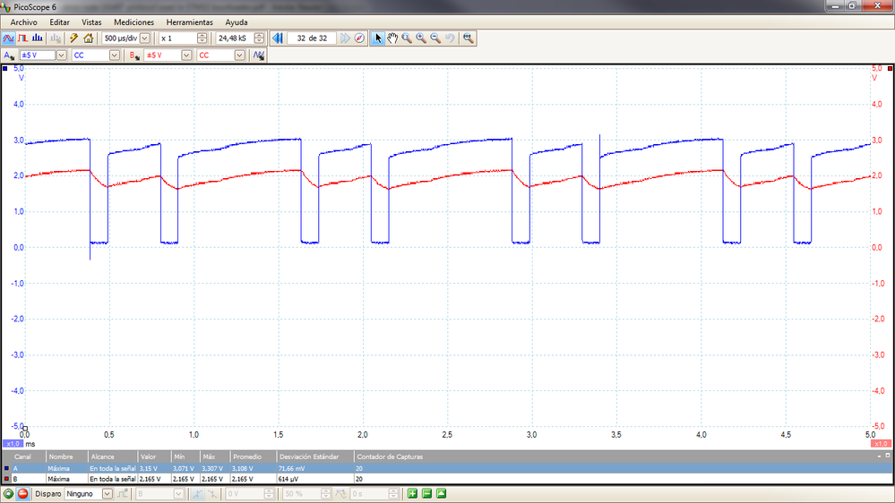

You're in right, maybe I run instead of walk. I'll try to change it. For this reasons, I last night thinking out start my program almost without all the rest of my code. But, maybe I should be test my module in the lowest level. Well, I only program my dsPIC with two uarts (in order to control some bits through Tera Term/hyperterminal/Real term program), a pin connnected to nBOOTLOADER(pin18 of STM32W) and a pic connected to nRESET (pin5 of STM32W) and a led. If I sent all the time the char ''127'' (0x07), I can see through oscillscope the Tx and Rx signals and I don't understand the RX behaviour:2013-03-11 5:31 AM

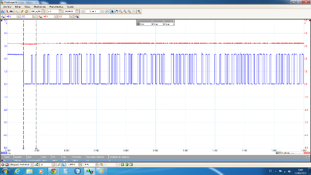

I've done some progresses, my first error is do not supply my zigbee module, the person who advice me, told me is it not necessary. Ok, I reset my dsPIC and I detected (with oscilloscope) the following frame from STM32W108, but I don't know what them mean.1st: 000001001 --> start bit + 00000100 + stop bit (1) = 0x04
2nd: 0x04
3th: 0x04
4th: 0x04;
5th: 0x58
6th: 0x507th: 0x04etc...2013-03-20 5:34 AM

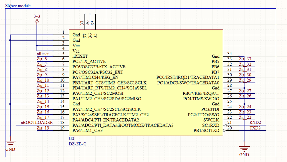

I've found out my problem, and I've achieved to connect that I wanted. Hardware connections:void ZigPrimerContacte(){
