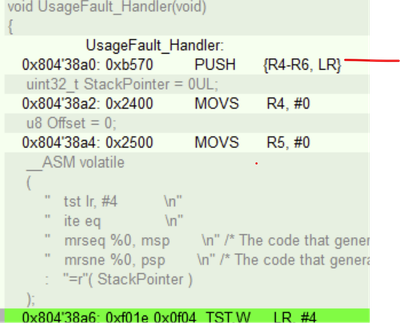

Okay, so I have been checking the disassembly and I see that R4, R5, R6 and LR have been pushed to the stack, and this is the reason I see an offset of 16 bytes.
I have removed two local variables and I see that the disassembly has changed like below. It still pushes R4 and LR and I see an offset of 8 bytes this time. Why is R4 and LR being pushed ?
I was under the impression that on exception it is always the below given registers that will be pushed on to the stack (additional bytes if float enabled). Why in my case additional bytes are pushed ?
Please note that MSP was used when the exception occurred.
