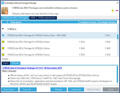

Ideally you let STM32 CubeMX pull the files directly. Why can't you do that?
Alternately you can download the .ZIP from the CubeXX package you need to install "From Local"

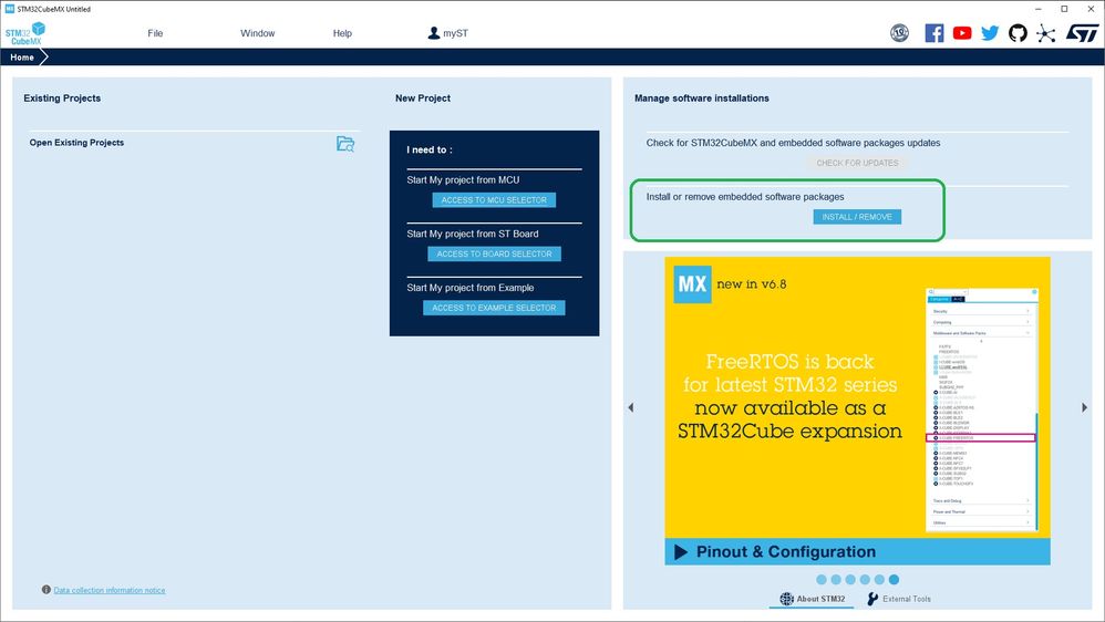

2024-05-08 3:17 PM - edited 2024-05-08 3:18 PM
On the STM32MCU Cube packages click on the button "From Local..." of this figure:
And follow the instructions.

2024-05-09 11:16 AM
2024-05-09 11:28 AM
Clicked on it, more than 10 minutes ago, in the same program section you are showing in the picture.. Nothing is happening.
