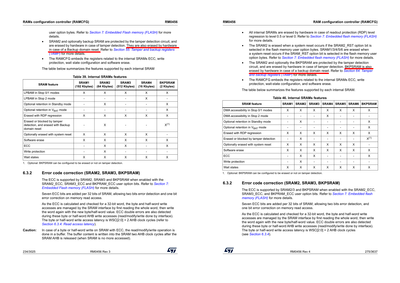

From the reference manual Rev.04 page 481 chapter 11.3.3 Backup domain reset it says: "A backup domain reset affects the LSE oscillator, the RTC, the TAMP, the backup registers, RCC_BDCR, and PWR_BDCR1. The reset of PWR_BDCR1 affects the backup SRAM."

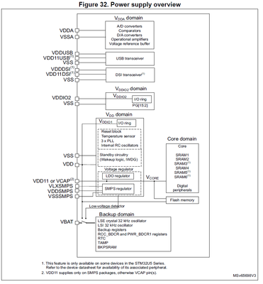

The SRAM2 is contained in the Core domain, in should not affected by the reset of the Backup domain which contains : the LSE, LSI, Backup registers, RCC_BDCR and PWR_BDCR1 registers, RTC, TAM and Backup RAM.

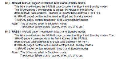

Thank for the description, I just want to check something. By default in Standby mode the contain of all SRAMs are lost unless you activate the RAM retention with the RRSB2 and RRSB1 bits in the PWR_CR1 register (the default value is 0x0000 0000) with the function HAL_PWREx_EnableSRAM2ContentStandbyRetention.

that is not the case in the specific situation. The standby (with SRAM2 loss) is in that step of our process not used to recover the LSE/LSI. I have some code that forces the backup domain reset and already stepping through that code with the debugger I can see the SRAM2 been erase. SRAM1 and SRAM3 keep their content in that situation. After that I force a software reset. (No low power standby sleep there.) The standby is used within the rest of the application if the configuration of the LSE/LSI is over.

I escalated your issue, and on the revisions X and under a backup domain reset can erased the contain of the SRAM2. This is something that we fixed on the next revision W, For the errata sheet I asked to team to add this case and it should appear on the next version.
For now the only workaround that we have for the revision X is to avoid to use the backup domain reset instruction.

Thank you for pointing this miss, much appreciated, We confirm that the behavior will be added in STM32U5 Errata as already done in STM32H5 series here : STM32H562xx/563xx/573xx device errata - Errata sheet in Limitation 2.2.14 SRAM2 is erased when the backup domain is reset that describes how to safely erase SRAM2 and avoid corruption of data not in purpose ( done for example during startup) and more important to describe the behavior observed by @PScal . Now for recent revW, that behavior is changed and indeed Reference Manual Rev4 take it in charge with a delayed synchronization for the Errata as described by @Aime .

We can for example safely reset SRAM2 or even before applying this Backup domain- reset to save content of SRAM2 in another SRAM and after safe SRAM2 erase to restore the content. another alternative is to get Rev W .
