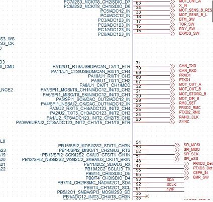

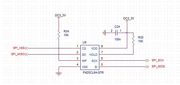

but not active spi2. schmetic is ...We’re moving the ST Community to a new platform to give you a better and more reliable community experience.
