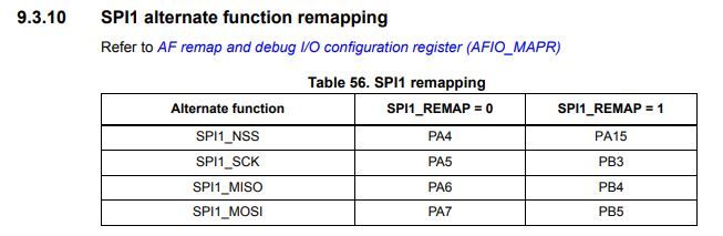

SPI1_NSS remapeed on PA15 pin. Try to set AFIO_MAPR.SPI1_REMAP = 1, and enable SPI1 clock in RCC: pins PA15, PB3, PB4 and PB5 belong to SPI1 as mentionned in the following SPI1 remapping table:
Please refer to the STM32F103 reference manual for more details on SPI1 remapping.

Hi, I want to use PA15 as GPIO, not the NSS wire of SPI1. Now the phenomenon is:
1. if I set SP1_REMAP=1, of course SPI1 use PA15 so I can't control it.
2. if I set SP1_REMAP=0, SPI1 use PA4 as its NSS. Then
2.1 Disable clock of SPI1, I can control PA15.
2.2 Enable clock of SPI1, I can't control PA15, it holds high.
So 2.2 means SPI1 always occupies PA15. Is there any solution?
