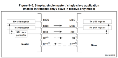

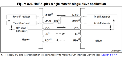

Do you want to use half-duplex to run a Half-Duplex communication or simplex communication?
In these cases, the SS works as a standard ‘chip select’ input and lets the slave communicate with the master in slave mode. In Master mode, the SS can be used either as an output or an input.
In a configuration with two or more independent slaves, the master uses a star topology with dedicated GPIO pins to manage the chip select lines for each slave separately.

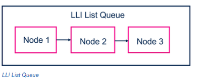

As mentioned in RM0456 section 17.4.5 GPDMA linked-list data structure "The direct programming mode, a channel can be programmed by a list of transfers, known as a list of linked-list items (LLI). Each LLI is defined by its data structure. " So, I didn't any limitation to one channel with a list of transfer.
So, if you used two nodes, the first node in the loop is where the LLR from the last node in the queue is pointed as mentioned in this FAQ "How to configure the linked list mode in STM32CubeMX".

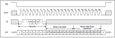

in fact it is a full duplex electrically,
but protocol is same as a SPI RAM/EEPROM
1st part of transaction, host send the wanted address, then 2nd part host read datas from device.
