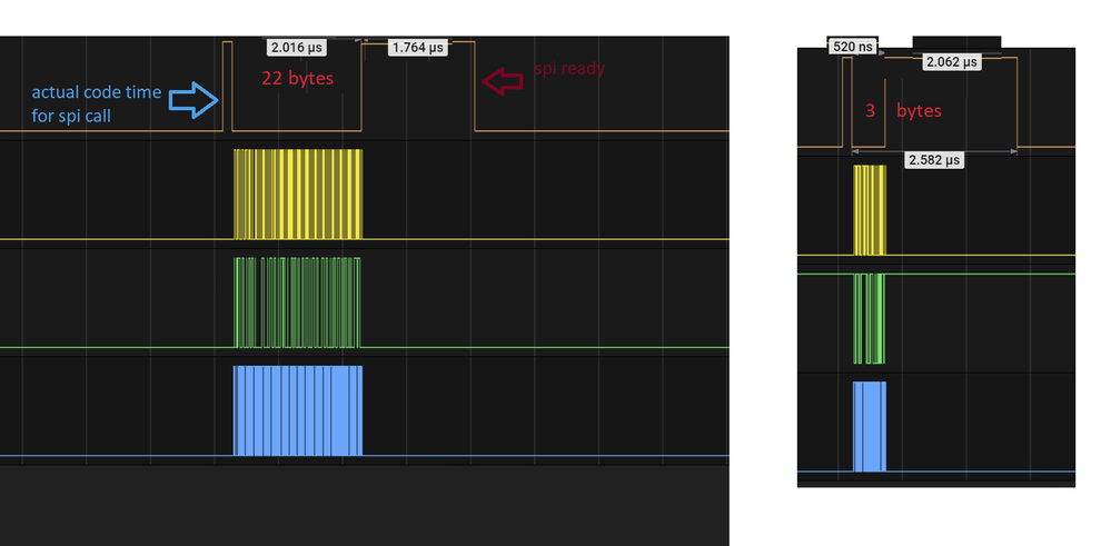

I was noticing that the SPI complete flag is up to 2us after transfer. When i send less data, its even longer?
is this the time it takes to shift data from peripheral to memory for dma? The CS (nss) line comes up when expected but TRANSFER_WAIT flag much later. When I cut the data short it takes even longer.

this is not the case, there is something wrong here.
I start a while after my transmission.
//bring a debug line high
while ( hspi5.State != HAL_SPI_STATE_READY) {}
//bring a debug line low
then in void HAL_SPI_IRQHandler(SPI_HandleTypeDef *hspi)
I put another debug line high at the hspi->State = HAL_SPI_STATE_READY;
now the line does take 700ns ( a bit much imo) but the low line from above happens another 600ns later. Just seems a bit odd it takes that long to jump out and call a few call backs
