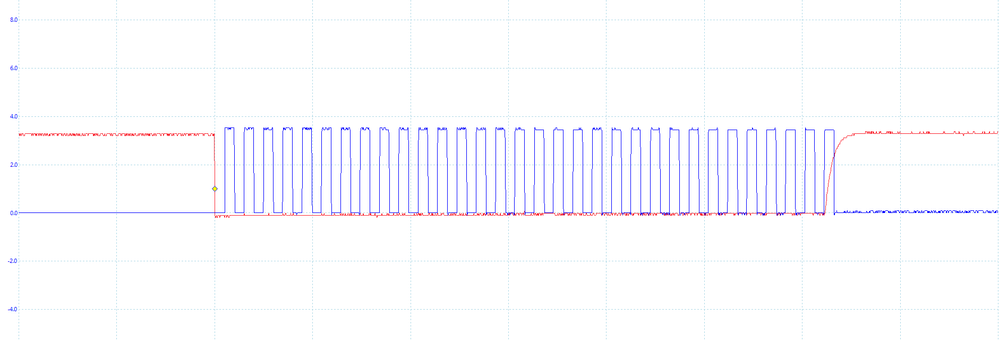

I think I found a way to do it:
1. configure the SPI in HW NSS Master mode WITHOUT NSSP (no pulse). 2. Manually edit the GPIO pin toGPIO_PULLUP (GPIO_Pin_11 in my example).

This is the result:
