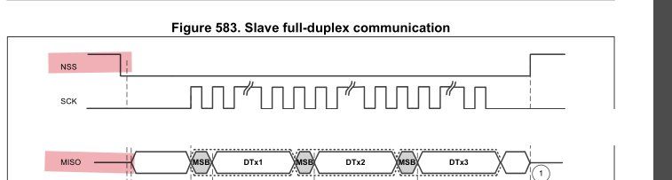

Issue 2: Curiously, MISO tri-stating behavior is not explicitly documented. You haven't said which family you're using, but for the one I use the figures in the RM suggest that when NSS is (configured for use but) not asserted MISO is tri-stated:
Whether that's convincing enough evidence, I can't decide for you.
