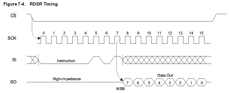

Yes, I know that read status command is 0x05 - I just made a mistake while posting it here and yes I did read the user manual as well as the data sheet of both the board as well as the memory.
1. I checked MISO with the Oscilloscope, it always stays low (The other pins are behaving properly). 2. I made a change - CPHA = 1, since according to the timing diagram the data is being sent at the trailing edge. (RDSR timing diagram).3. I tried with sending a dummy byte. I still have no luck. (I sent both 00 as well as FF as the dummy byte)4. I found another mistake - I wasn't making the HOLD and WP high (while copy-pasting I forgot to change the pin number)5. The maximum APB2 frequency is 60MHz and APB2/4 will be 15 MHz, however the EEPROM requires 20MHz - will that be a problem?Does the ''SPI1_send'' function seem fine to you? Have I initialized SPI properly?This is the code that I finally tried with - #include ''stm32f2xx.h'' void init_SPI1(void) { GPIO_InitTypeDef GPIO_InitStruct; SPI_InitTypeDef SPI_InitStruct; // enable clock for used IO pins RCC_AHB1PeriphClockCmd(RCC_AHB1Periph_GPIOA, ENABLE); RCC_AHB1PeriphClockCmd(RCC_AHB1Periph_GPIOB, ENABLE); /* configure pins used by SPI1 * 1 - CS - PB0 * 2 - MISO - PA6 * 3 - WP - PB2 * 4 - GND * 5 - MOSI - PA7 * 6 - SCK - PA5 * 7 - HLD - PB1 * 8 - VCC */ GPIO_InitStruct.GPIO_Pin = GPIO_Pin_7 | GPIO_Pin_6 | GPIO_Pin_5; GPIO_InitStruct.GPIO_Mode = GPIO_Mode_AF; GPIO_InitStruct.GPIO_OType = GPIO_OType_PP; GPIO_InitStruct.GPIO_Speed = GPIO_Speed_50MHz; GPIO_InitStruct.GPIO_PuPd = GPIO_PuPd_NOPULL; GPIO_Init(GPIOA, &GPIO_InitStruct); // connect SPI1 pins to SPI alternate function GPIO_PinAFConfig(GPIOA, GPIO_PinSource5, GPIO_AF_SPI1); GPIO_PinAFConfig(GPIOA, GPIO_PinSource6, GPIO_AF_SPI1); GPIO_PinAFConfig(GPIOA, GPIO_PinSource7, GPIO_AF_SPI1); // Configure the HLD,CS and WP pins GPIO_InitStruct.GPIO_Pin = GPIO_Pin_0 | GPIO_Pin_1 | GPIO_Pin_2; GPIO_InitStruct.GPIO_Mode = GPIO_Mode_OUT; GPIO_InitStruct.GPIO_OType = GPIO_OType_PP; GPIO_InitStruct.GPIO_Speed = GPIO_Speed_50MHz; GPIO_InitStruct.GPIO_PuPd = GPIO_PuPd_UP; GPIO_Init(GPIOB, &GPIO_InitStruct); GPIOB->BSRRL |= GPIO_Pin_0; // set PB0 (CS) high GPIOB->BSRRL |= GPIO_Pin_1; // set PB1 (HLD) high GPIOB->BSRRL |= GPIO_Pin_2; // set PB2 (WP) high // enable peripheral clock RCC_APB2PeriphClockCmd(RCC_APB2Periph_SPI1, ENABLE); /* configure SPI1 in Mode 0 * CPOL = 0 --> clock is low when idle * CPHA = 1 --> data is sampled at the second edge */ SPI_InitStruct.SPI_Direction = SPI_Direction_2Lines_FullDuplex; // set to full duplex mode, seperate MOSI and MISO lines SPI_InitStruct.SPI_Mode = SPI_Mode_Master; // transmit in master mode, NSS pin has to be always high SPI_InitStruct.SPI_DataSize = SPI_DataSize_8b; // one packet of data is 8 bits wide SPI_InitStruct.SPI_CPOL = SPI_CPOL_Low; // clock is low when idle SPI_InitStruct.SPI_CPHA = SPI_CPHA_1Edge; // data sampled at second edge SPI_InitStruct.SPI_NSS = SPI_NSS_Soft | SPI_NSSInternalSoft_Set; // set the NSS management to internal and pull internal NSS high SPI_InitStruct.SPI_BaudRatePrescaler = SPI_BaudRatePrescaler_4; // SPI frequency is APB2 frequency / 4 SPI_InitStruct.SPI_FirstBit = SPI_FirstBit_MSB;// data is transmitted MSB first SPI_Init(SPI1, &SPI_InitStruct); SPI_Cmd(SPI1, ENABLE); // enable SPI1 } uint16_t SPI1_send(uint8_t data) { SPI1->DR = data; // write data to be transmitted to the SPI data register while( !(SPI1->SR & SPI_I2S_FLAG_TXE) ); // wait until transmit complete while( !(SPI1->SR & SPI_I2S_FLAG_RXNE) ); // wait until receive complete while( SPI1->SR & SPI_I2S_FLAG_BSY ); // wait until SPI is not busy anymore return SPI1->DR; // return received data from SPI data register }int main(void){ uint16_t received_val = 0; init_SPI1(); while(1) { GPIOB->BSRRH |= GPIO_Pin_0; // set PB0 (CS) low SPI1_send(0x05); //The read status opcode GPIOB->BSRRL |= GPIO_Pin_0; // set PB0 (CS) high GPIOB->BSRRH |= GPIO_Pin_0; // set PB0 (CS) low received_val=SPI1_send(0xFF); //The dummy byte GPIOB->BSRRL |= GPIO_Pin_0; // set PB0 (CS) high }}2014-04-19 1:58 AM

Yes, one of the salient details expressed in the timing diagram is the CS is low during the transaction.
20 MHz is the maximum speed, it can run significantly slower. I've used code materially similar to readhttp://www.winbond.com/NR/rdonlyres/7EB3B29C-1B35-421C-AA24-F430B51C776A/0/W25Q16BV.pdf
