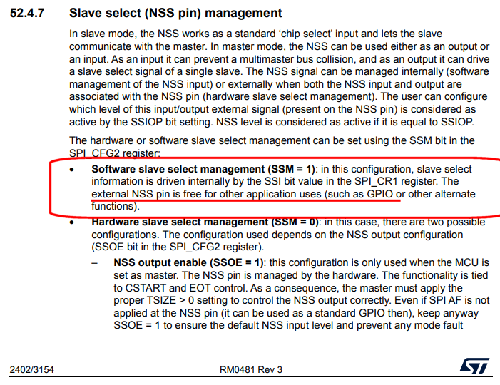

I am trying to use SPI communication with the STM32H562 (for FPGA programming purposes).
The reference manual states that if SPI_CFG2's SSM = 1, the NSS can be toggled High/Low by switching the SSI bit in SPI_CR1.
However, the switching of SSI is not reflected in the oscilloscope observations.
Additionally, I tried setting the NSS port as GPIO instead of SPI communication and using HAL_WritePin to configure it, but this was also not reflected.
When using the NSS port for SPI, should I set the start register bits such as SPE and CSTART?

@Thoufiel wrote:The reference manual states that if SPI_CFG2's SSM = 1, the NSS can be toggled High/Low by switching the SSI bit in SPI_CR1.
No, that's not what it says:

2025-04-16 1:34 AM
Thank you for your reply.
I had read that section before my initial question, and regarding the content just before the red line,
I understood it as "Slave select can be performed by setting the SSI bit."
What does "internally" mean in this context?

2025-04-16 5:45 AM
This is what it does, but the state is not reflected on the NSS pin. It's only internal. The NSS pin on a slave is an input anyway, wouldn't make sense to drive it.
