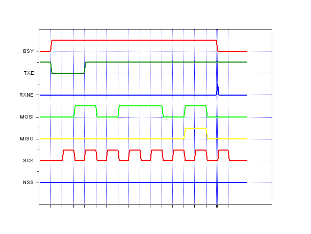

2020-11-03 8:36 AM
2020-11-03 9:20 AM
Yes I don't use the 'F1, am aware that GPIO is different but don't really know the exact implementation. I see you know what I am talking about nevertheless :)
Very nice diagram. Care to tell us how did yo produce it?
The upper 3 signals, they are from master or slave? Can you try to produce the same for the other SPI?
Is there any other hardware connected, or are the lines only plainly looped back to themselves?
Try perhaps lowering the "OSPEEDR" setting, especially for clock.

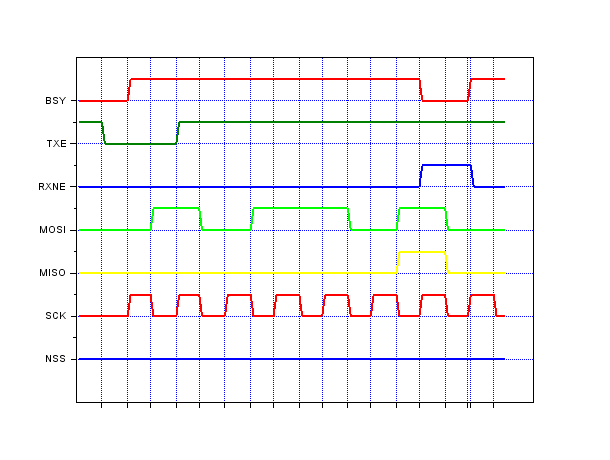

2020-11-03 10:58 AM
This is my logic self analyzer technique. The DMA, on a timer signal, reads SPIx->SR and the state of the pins (GPIOx->IR) and stores it in a memory buffer. Then we transfer the accumulated data to a PC for processing.
Those are from slave. It is for master:> Is there any other hardware connected, or are the lines only plainly looped back to themselves?
They are only looped back to themselves.
And yes! The device operates normally in all modes after decreasing the speed of outputs. I should think.
