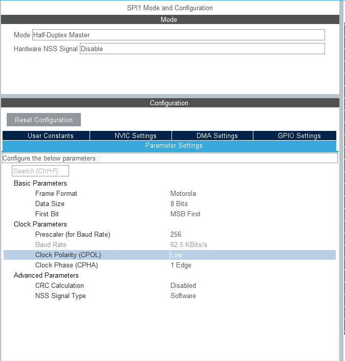

My SPI configuration in CubeMX:

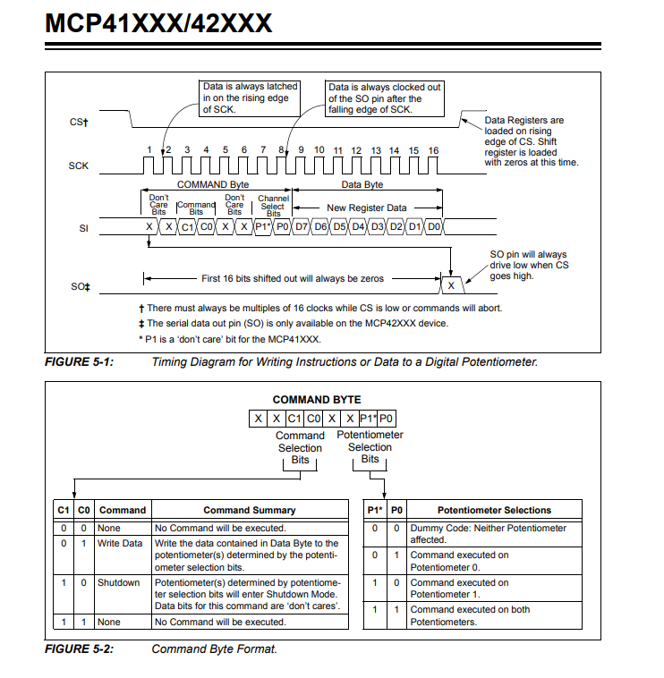

According to the documentation:
I need to send 1 command byte and 1 data byte.

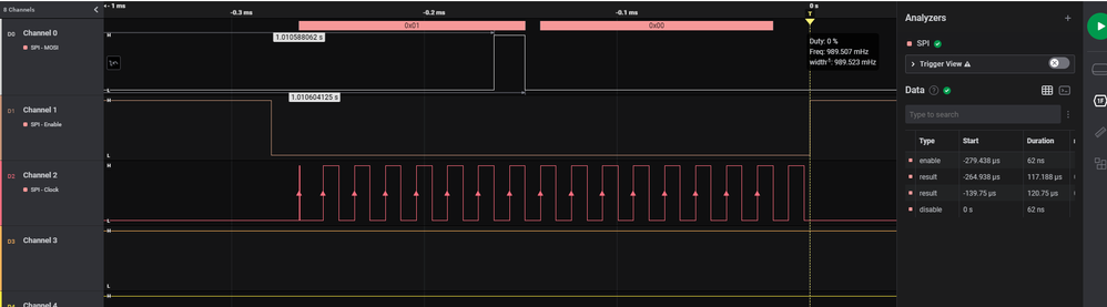

}Now in my SALAE software, I see the following:
I would like to understand why the first clock cycle is very short. Is that a problem with my logic analyzer or that is normal behaviour?
2022-04-21 6:17 AM
Send a byte with CS high to enable the peripheral (the data will be ignored, but the peripheral will be enabled as a side effect).
The peripheral is not enabled until the first HAL_SPI_Transmit call which means the pins aren't being driven until that point.
