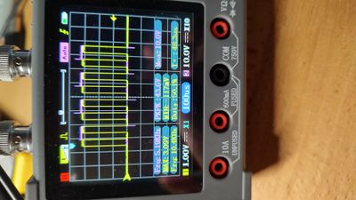

2024-08-18 7:06 AM - edited 2024-08-18 11:30 AM
Thanks for the hint. I think it's any hardware issue. The scope looks good:
Edit:
The problem was that I swapped RCLK and SRCLK pins. I hate the data sheet, the description says
| RCLK | 12 | 14 | I | RCLK Input |
| SRCLK | 11 | 14 | I | SRCLK Input |
Man, this is not very helpful actually 8-(
