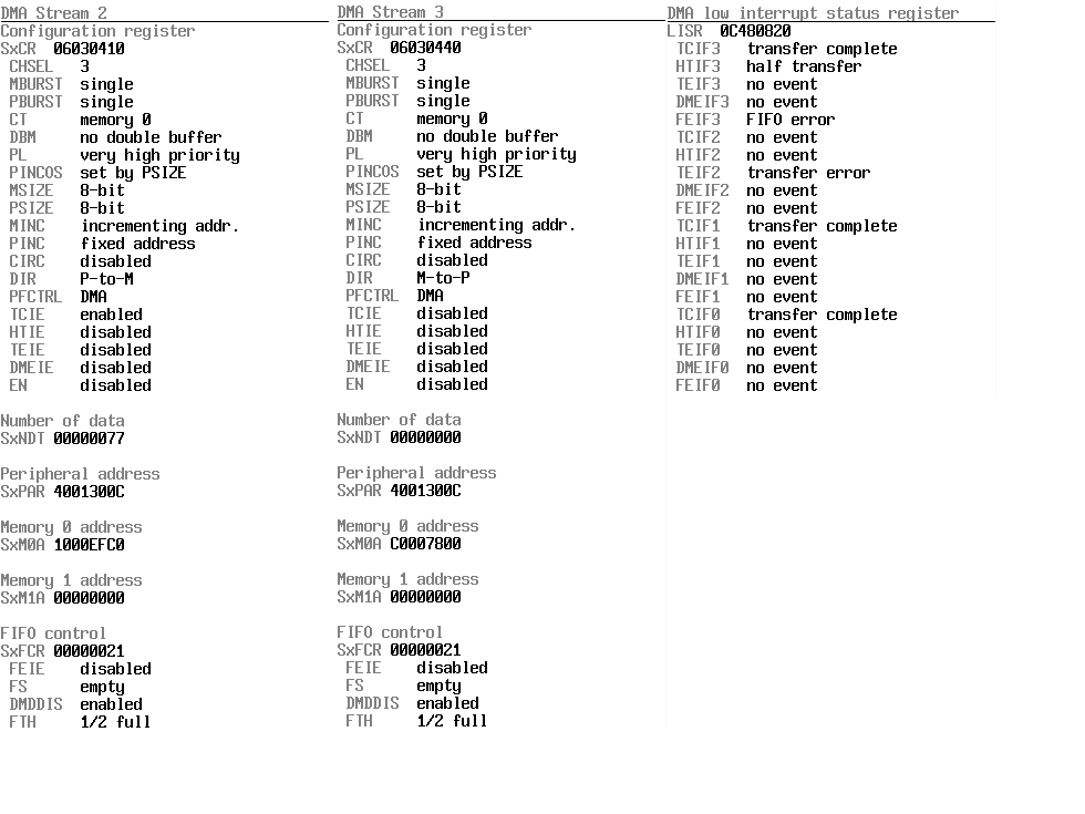

I set a break point at SPI_I2S_DMACmd(SPI1, SPI_I2S_DMAReq_Tx, DISABLE);
TCIF3 which is for TX shows 1 means transfer complete.The registers in DMA stream3 have no problems.EN bit 0SxNDT(number of data) 0 However, TEIF2 which is for RX shows 1 means transfer error.Here are the registers in DMA stream2.EN bit 0SxNDT 00000077For the data amount, I set DMA_BufferSize 120 which is 0x78Apparently, something wrong for the DMA.2014-09-18 7:02 AM

2014-09-18 7:34 AM
You never said which derivative do you use, but if it's STM32F4, SxM0A points into CCM, which is not accessible from DMA.

> I am using internal SRAM.
The content of SxM0A register indicates, that you are using the CCM RAM as the target for the Rx DMA, and the DMA controller can't access it. Read the manual to learn what is CCM RAM - there are several internal RAMs in your device (which you still failed to identify). I guess you placed the Rx buffer onto the stack or dynamically allocated into heap, and you have set stack and heap into the CCM RAM in your toolchain. Read the manual of your toolchain to learn how to place a buffer into an explicit memory area.---

I set the RX DMA_Memory0BaseAddr to 0xC0000000 which is the starting address for external SDRAM. There is no transfer error anymore.
But it seems like the bit I got is wrong. At least, there is a progress.We’re moving the ST Community to a new platform to give you a better and more reliable community experience.
