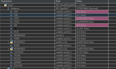

More info :
  • Before trying to setup DMA, I used SPI with IT. Everything worked as expected. That's not a hardware problem on my platform.
  • I checked MISO and MOSI signals with a scope, they are as expected. That makes me think that the microcontroller receive the correct answer on MISO signal.
  • SPI1 status when entering HAL_SPI_TxRxCpltCallback() function
