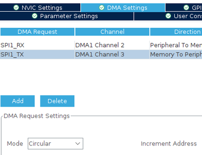

first set the two dma channels , rx + tx , in Cube as circular , enable callbacks .
then..
HAL_DMA_Init(&hdma_spi1_rx);
HAL_DMA_Init(&hdma_spi1_tx);
fresult = HAL_SPI_Receive_DMA(&hspi1, ESPinbuf , (sizeof(ESPinbuf))); // ESP input-loop start
fresult = HAL_SPI_Transmit_DMA(&hspi1, ....);
Then in callbacks use data & set data ...btw why send data stream to ADC ? is useful ?
