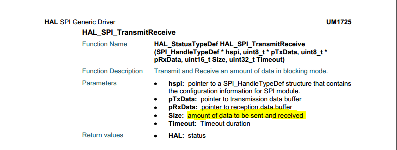

Hi Sandeep,
According to the HAL manual, in this case for STM32F4 family the size refers to the amount of data to be sent and received, for some STM32 microcontrollers families the data can be only of 8bits or 16bits, so in this case as the buffer pointer is to a uint8_t it refers to the amount of bytes to be sent and received, if data is configured in 16bits the spi peripheral fix the frames to be sent 2 by 2 bytes each time.
