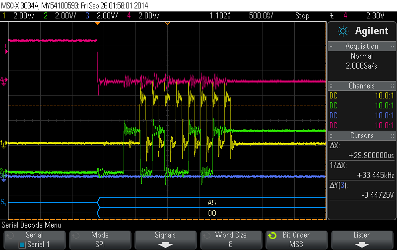

I am seeing some strange behavior in my SPI port.
I expect that it will be set up as CPOL = 0, CPHA = 0 and for the bus to output 0xA5.What I see is that not only is MOSI transitioning on the wrong edges, but the data appears shifted.I have inserted my code and a scope capture of the output. Red is CS, Yellow is CLK, and Green is MOSI.Any ideas as to what is going on here?-------------------------------------------Code------------------------------------------------- GPIO_InitTypeDef GPIO_InitStructure; SPI_InitTypeDef SPI_InitStructure; // Enable GPIO clk RCC_AHB1PeriphClockCmd(EEPROM_MOSI_AHB1Periph_GPIOx, ENABLE); RCC_AHB1PeriphClockCmd(EEPROM_MISO_AHB1Periph_GPIOx, ENABLE); RCC_AHB1PeriphClockCmd(EEPROM_SCLK_AHB1Periph_GPIOx, ENABLE); RCC_AHB1PeriphClockCmd(EEPROM_CS_AHB1Periph_GPIOx, ENABLE); // Connect Pins to AF GPIO_PinAFConfig(EEPROM_SCLK_GPIOx, EEPROM_SCLK_SOURCE, EEPROM_AF); GPIO_PinAFConfig(EEPROM_MOSI_GPIOx, EEPROM_MOSI_SOURCE, EEPROM_AF); GPIO_PinAFConfig(EEPROM_MISO_GPIOx, EEPROM_MISO_SOURCE, EEPROM_AF); // Pin Configuration GPIO_StructInit(&GPIO_InitStructure); GPIO_InitStructure.GPIO_Mode = GPIO_Mode_AF; GPIO_InitStructure.GPIO_Speed = GPIO_Speed_50MHz; GPIO_InitStructure.GPIO_OType = GPIO_OType_PP; GPIO_InitStructure.GPIO_PuPd = GPIO_PuPd_DOWN; GPIO_InitStructure.GPIO_Pin = EEPROM_SCLK_PIN_x; GPIO_Init(EEPROM_SCLK_GPIOx, &GPIO_InitStructure); GPIO_InitStructure.GPIO_PuPd = GPIO_PuPd_NOPULL; GPIO_InitStructure.GPIO_Pin = EEPROM_MOSI_PIN_x; GPIO_Init(EEPROM_MOSI_GPIOx, &GPIO_InitStructure); GPIO_InitStructure.GPIO_Pin = EEPROM_MISO_PIN_x; GPIO_Init(EEPROM_MISO_GPIOx, &GPIO_InitStructure); GPIO_SetBits(EEPROM_CS_GPIOx, EEPROM_CS_PIN_x); GPIO_InitStructure.GPIO_Mode = GPIO_Mode_OUT; GPIO_InitStructure.GPIO_PuPd = GPIO_PuPd_NOPULL; GPIO_InitStructure.GPIO_Pin = EEPROM_CS_PIN_x; GPIO_Init(EEPROM_CS_GPIOx, &GPIO_InitStructure); // Init SPI peripheral // Enable SPI clk EEPROM_CLK_INIT(EEPROM_CLK, ENABLE); SPI_I2S_DeInit(EEPROM_SPIx); SPI_StructInit(&SPI_InitStructure); SPI_InitStructure.SPI_Direction = SPI_Direction_2Lines_FullDuplex; SPI_InitStructure.SPI_Mode = SPI_Mode_Master; SPI_InitStructure.SPI_DataSize = SPI_DataSize_8b; // CPHA = 0 CPOL = 0 SPI_InitStructure.SPI_CPOL = SPI_CPOL_Low; SPI_InitStructure.SPI_CPHA = SPI_CPHA_1Edge; SPI_InitStructure.SPI_NSS = SPI_NSS_Soft; SPI_InitStructure.SPI_BaudRatePrescaler = SPI_BaudRatePrescaler_8; SPI_InitStructure.SPI_FirstBit = SPI_FirstBit_MSB; SPI_Init(EEPROM_SPIx,&SPI_InitStructure); // Set so that the SPI Master does not think someone is trying to take over the bus (Sets SSI bit) SPI_NSSInternalSoftwareConfig(EEPROM_SPIx,SPI_NSSInternalSoft_Set); eeprom_csd(); SPI_Cmd(EEPROM_SPIx,ENABLE); SPI_I2S_SendData(EEPROM_SPIx,0xA5);-------------------------------------------Code-------------------------------------------------2014-09-27 2:17 AM
I must admit this trace bugs me, software looks good, and this shift shall not happen.
Is this possible for you to post a single file that compiles and produces the error for us to reproduce. Also tell us which device you are using, and a few words about your HW target. Last, do not configure GPIO for 50MHz where 25 MHz is good enough, this will reduce the overshoot on electrical signals.2014-09-27 3:33 PM
The target is an STM32F407. I will put together a file this weekend that will be able to compile on any Chinesium breakout board (or your favorite ST dev-kit), and I will post it on this thread.
At first I thought that the CPHA signal was incorrect, but on closer inspection, it really looks like the data is shifted backwards in time by a half clock cycle. I am not sure how this is possible.2014-09-28 4:40 AM

I found the problem, my scope had almost exactly a half clock cycle skew on the probe input for the clock. I am not sure how it ended up being so close, but I found it when I started varying the SPI baud rate and found that MOSI did not appear to be edge triggered....
A little embarrassing, but sometimes it is the measurement hardware and not the code.We’re moving the ST Community to a new platform to give you a better and more reliable community experience.
