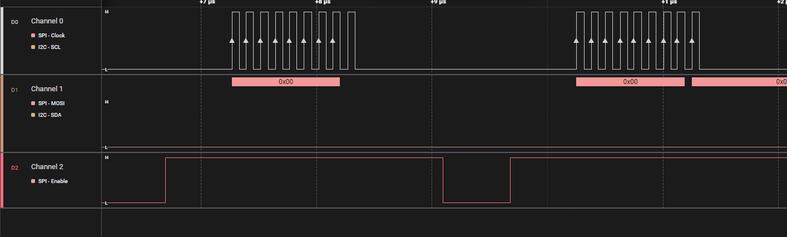

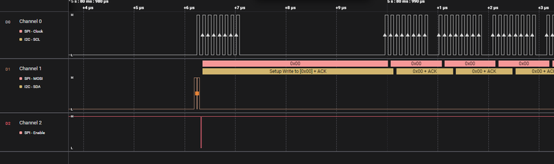

I have a display, which has only CLK, DI and CS pin for SPI communication. It uses TI protocol.
The original driver is only working with raspberry pi, I try to import it into my custom STM32 MCU board, the CLK and CS signals seem okay, Only the MOSI signal is always low. it seems no data is really sent to the display.
here is the signal capture from logic analyzer.

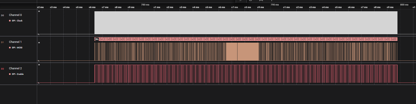

The whole write sequence:
zoom in, single byte write:
what could be the reason? Thanks in advance.

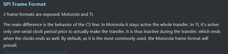

2024-03-14 3:29 PM - edited 2024-03-14 3:34 PM
Hi @tjaekel
good news!!!

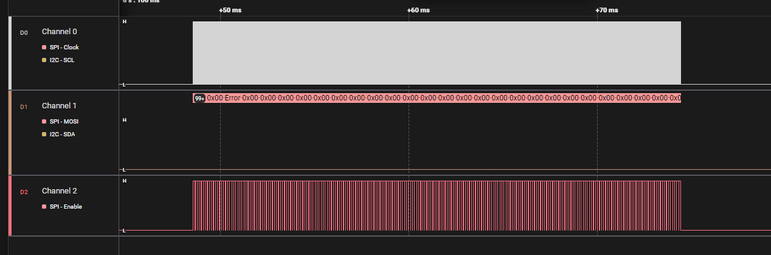

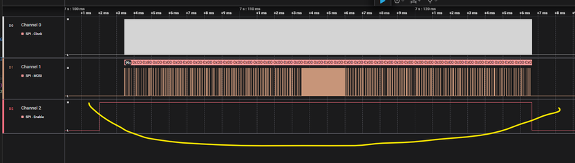

it works with this kind of CS signal:
the CS signal keeps always active until the last transfer session.
not works, when just set CS active for every transfer session like this:
I used Motorola mode(CPOL=0,CPHA=0) and keep the CS always active the whole transfer.
@tjaekel Thanks a lot again!!! I learned also a lot:)
2024-02-20 2:10 PM
Bit pointless to guess why.
Diagram all the connections, and provide a data sheet to the module or controller you're attaching too.
Either it isn't strapped in SPI mode, or expects CS to be low going.

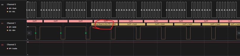

2024-02-21 1:13 PM - edited 2024-02-21 2:01 PM
thanks for reply!
this is signal capture from raspiberry pi, you can see the CS pin is also high during write-operation.
there are only 3 pins(clock, MOSI, CS), I thought the data are transformed only in this direction: uC----> display. how to explain the read-operation in the sequence?

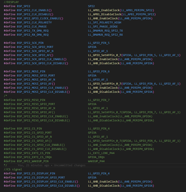

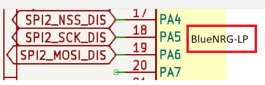

Here is my hardware connection to display:

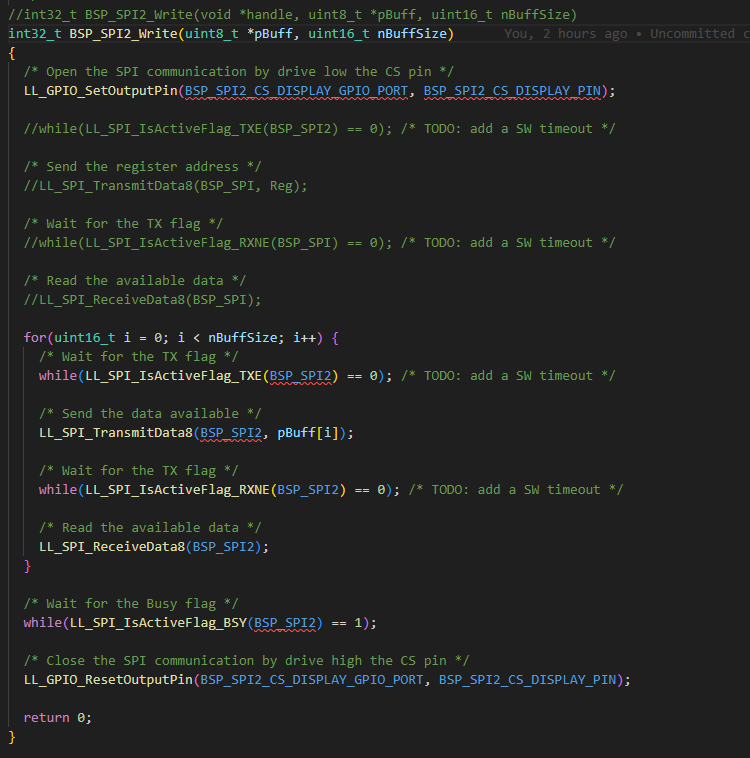

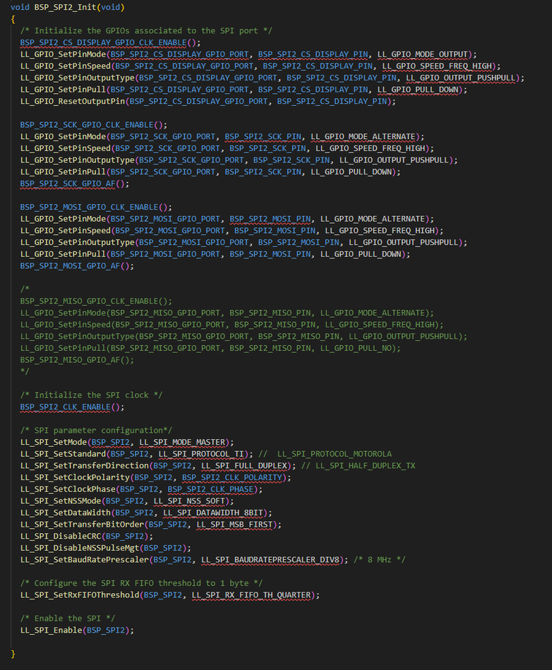

here is SPI2 init function:
here is pin definition:
2024-02-21 2:02 PM
Show the code sending the data
2024-02-21 2:21 PM
2024-02-21 2:52 PM
Please use this button to properly post source code - not as images:
2024-02-21 3:52 PM - edited 2024-02-21 3:53 PM
Ok, this is getting really laboured.
You keep showing very narrow context.
And how are you calling this? Show the code and the data array that it's moving. Perhaps print out the values from the array as you're sending it? An array of zeros will transmit as shown in the logic analyzer traces.

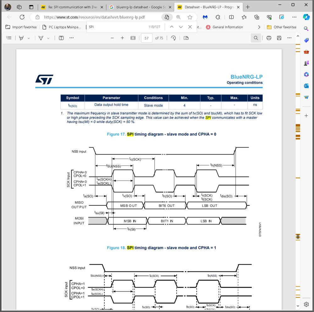

You're using an BlueNRG-LP part?
https://www.st.com/en/wireless-connectivity/bluenrg-lp.html
You're connecting to WHAT display part? Provide link to manual for display, and provide a diagram of exactly how it's wired.
Could anything be shorting the MOSI pin?
Can you drive it up/down as a GPIO?

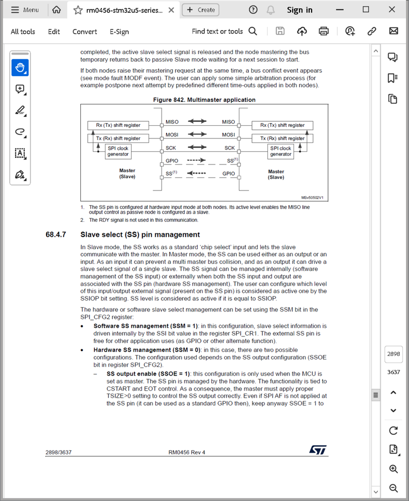

2024-02-21 6:21 PM
OK, you want to use SW_NSS: you drive the NSS signal yourself (as GPIO pin). Fine, works (if low active).
But you have to drive low for enable and high for disable. You do it in the reverse order (your NSS signal is "high-active", even I can see on your scope picture). I am pretty sure, this cannot be right (but it does not answer yet why you do not see MOSI toggling. BTW: on your RPi scope picture - even there I do not see MOSI toggling).
Maybe, you think: when you drive NSS high - it enabled the SPI2 as master, to start sending. NO, there is not any correlation!.
I think: you have to enable still the Master, even in SW_NSS mode: it is not enough just to do LL_SPI_Enable(BSP_SPI2);
There is a bit inside the Master, called SSI bit (SSM = 1 enables "SW_NSS" mode, but you have to "toggle" still this SSI bit: this enables the SPI Master so that it can start to send!
Maybe you mixed it up: this SSI bit is "high active", you have to set it to 1. It acts like a NSS signal. The Master is listening on the NSS input: if "bus is occupied, NSS is low - the Master will not start to send". Even you do not drive neither use the NSS in HW mode - you have to "enable still NSS via this SSI bit" (I think).
So, this bit should be set to 1, but the GPIO for NSS signal is set to low.
Strange is just that you see a SCLK signal. But I saw in BlueRNG-LP datasheet: the SPI on this side can be a Master as well. Are you sure you are talking from MCU as SPI Master to a SPI Slave?
If the module is also acting as SPI Master - it would generate the clock (and you, as MCU, have to act as a SPI Slave). Maybe the SCLK comes from the SPI Master on the other end (it is not your signal). Actually not, because your SCLK signal is aligned with the NSS you generate.
So, check:
a SPI Master still needs the SSI bit (in order to start a transfer)? I think.
A SPI_NSS signal is "low active" (as NSS stands for)
2024-02-21 6:41 PM
Oh, BTW: how do you connect Master and Slave? Which MCU do you use?
On my STM32U5A5 MCU PA6 is SPI1_MISO.
Is PA6 really MOSI? If it is MISO - it would explain why you do not see anything (an input on MCU, but with NSS high the slave would not send anything). Is PA6 floating? (you can check with scope, if you touch the probe with fingers, to see 60Hz noise).
BTW: if your device on other end is not a Slave, a Master instead: it could explain why do you see SCLK: if it has the similar feature to "check NSS even as an input on master" (if "SPI bus is busy" before starting as Master Tx) - your high active NSS lets the other Master assume, the bus is free (and now the other master generates SCLK, talking to you as a slave).
