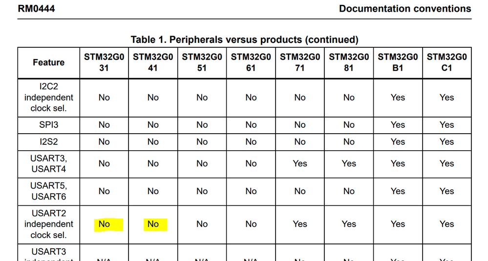

Clock selection for USART2 isn't available on these devices per the RMs.

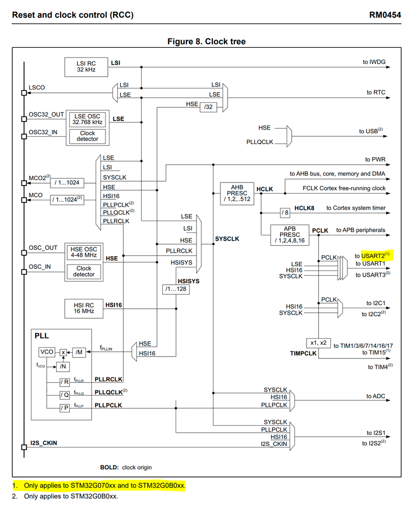

Imen.D
You are right @TDK​.
I checked the spec and I confirm that the USART2 is only applies to STM32G070xx and to STM32G0B0xx devices.
So, the HAL define is correct, and there is no missing.
