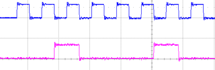

I am using the STM32F4 as an SPI slave.
The signal is comming with LSB first, CPOL=0, CPHA=0. See image below, which shows the reception of 0x44:hspi1.Instance = SPI1;
hspi1.Init.Mode = SPI_MODE_SLAVE;
hspi1.Init.Direction = SPI_DIRECTION_2LINES_RXONLY;
hspi1.Init.DataSize = SPI_DATASIZE_8BIT;
hspi1.Init.CLKPolarity = SPI_POLARITY_HIGH;
hspi1.Init.CLKPhase = SPI_PHASE_2EDGE;
hspi1.Init.NSS = SPI_NSS_SOFT;
hspi1.Init.BaudRatePrescaler = SPI_BAUDRATEPRESCALER_2;
hspi1.Init.FirstBit = SPI_FIRSTBIT_LSB;
hspi1.Init.TIMode = SPI_TIMODE_DISABLED;
hspi1.Init.CRCCalculation = SPI_CRCCALCULATION_DISABLED;
hspi1.Init.CRCPolynomial = 10;
HAL_SPI_Init(&hspi1);
2015-10-01 6:33 AM
Hi CaCO3,
No all configurations give you correct data display, you have to respect this condition''The idle state of SCK must correspond to the polarity selected in the SPI_CR1 register (by pulling up SCK if CPOL=1 or pulling down SCK if CPOL=0).''as indicated in the page 869 ( Clock phase and clock polarity) of RM0090. -Shahrzad-
2015-10-05 12:24 AM
I did some further tests. It seems that the inputs are very sensitive to noise. If I shield the wires better and add a filter, it works much better.
Additionally, If I use a CS input (SPI_NSS_HARD_INPUT), it works without a problem.We’re moving the ST Community to a new platform to give you a better and more reliable community experience.
