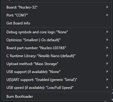

I use Arduino IDE and "STM32 MCU based boards" library to program Nucleo32. Here are the settings:
I connect it directly using USB to computer.
