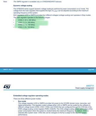

2024-09-10 1:51 PM
Dear @madhu1 ,
this might help :
let me know if it confirms your observations. You can play with the VOS Bits and increase the VCore voltage to reach 250MHz after this power up phase .
Ciao
STOne-32
