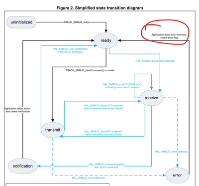

@BobSCHMITZ The picture in the OP is exactly from AN4502.
2023-10-17 11:52 AM
@Pavel A.your are right, of course.
That still leaves the question of whether this person is using the code that comes along with the app note (cube_smbus). It appears to me that they are not, but I could be mistaken there as well since I base that on their mention of HAL_SMBUS_Master_Transmit_IT(). That function is not (usually) called directly from user code when using the AN4502 provided code. So I don't know if they are writing their own, or trying to debug the cube_smbus code.

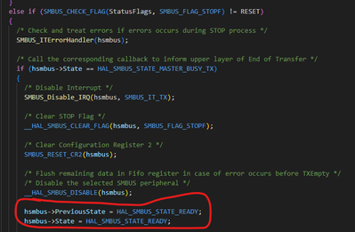

I am using SMBus Expansion code. The application layer was getting error and the reason found was HAL_SMBUS_Master_Transmit_IT() returning HAL_BUSY after an SMBUS error occurs (explained in the post).
The expansion code does not seem to do anything to recover for SMBus HAL driver after an error. I have noticed that if a NACK error (HAL_SMBUS_ERROR_ACKF) happens, another ISR happens for STOPF and this clears the HAL SMSUS driver state in function SMBUS_Master_ISR(). But, I have not seen this for errors HAL_SMBUS_ERROR_BERR, HAL_SMBUS_ERROR_BUSTIMEOUT and HAL_SMBUS_ERROR_ARLO.
