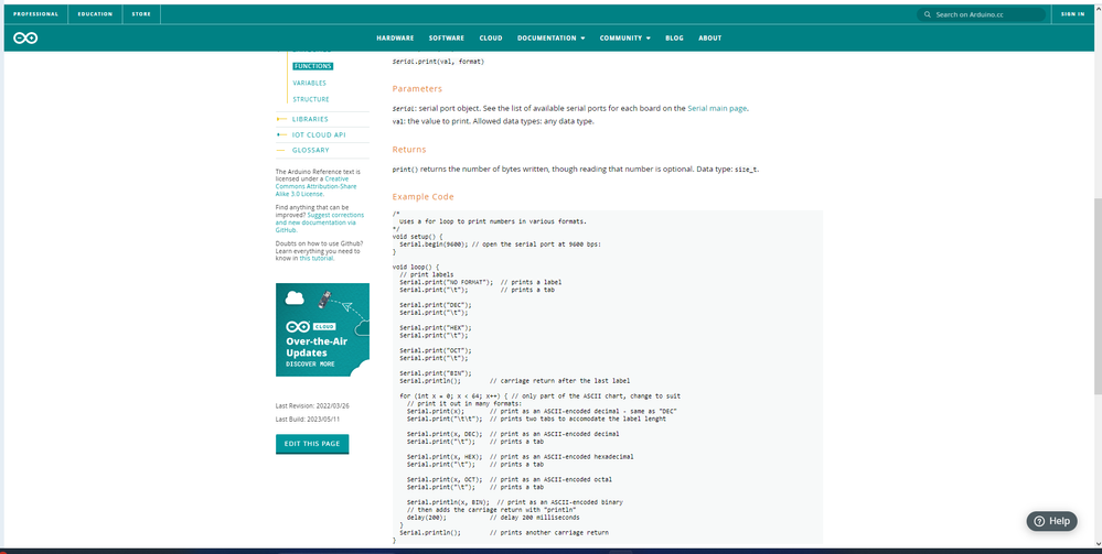

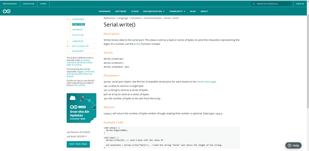

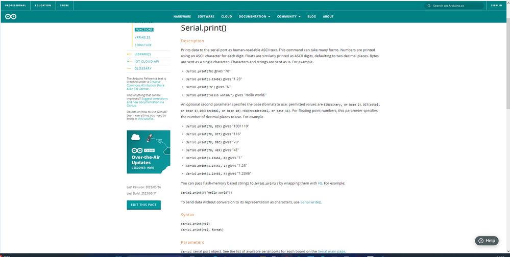

In the pictures you can find the explanation of arduino "serial.write" and "serial.print.
To retain about arduino serial.print is the following:
To retain about arduino serial.write is the following:
Serial.write(78); // send a byte with the value 78, so i think serial.write(78) gives "N" --> "N" is the ASCI character linked on decimal 78.
