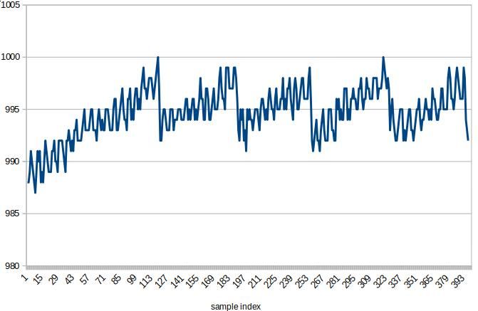

Over the past month, I've been trying to figure out if the DAC in the STM32F3 actually has a silicon bug. I observe a sawtooth with an approx 1 minute period in the DAC output (as measured by the ADC on the same chip). The first large "tooth" is always ~2mins long, then the period is roughly 1minute after that. Here's an example of what I mean:

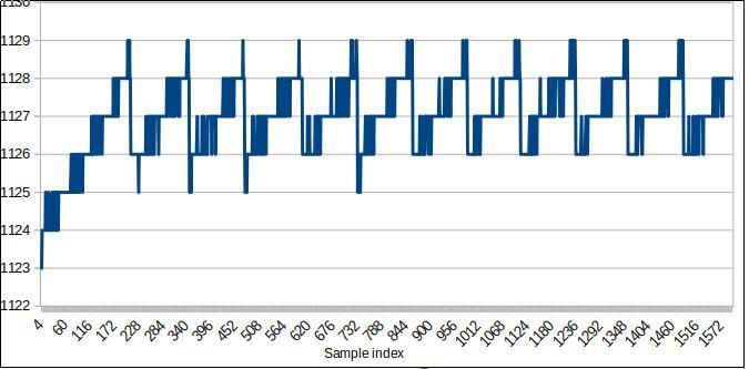

OK, I did more testing over the weekend with the Nucleo board and a wide range of impedances and filters connected to DAC1OUT (unbuffered). I've basically come to the conclusion that the DAC won't be stable unless there's a very good approximation of infinite impedance across all relevant frequencies at the terminal when the internal voltage follower op amp is not enabled (or more realistically, not available if you're not using DAC1Ch1). This includes my usage case: not working when connected directly to a 2nd-order active filter:
That degree of extraneous inaccuracy is OK for toys & music, but not for precision measurement work.
Both the inverting and voltage follower configs in AN4566 work, but I haven't found another useful config that's reliably stable. Unfortunately modelling the DAC as an R2R ladder is therefore not accurate, and I really wish ST had included such details about stability in their application note documentation because it would have saved me a lot of wasted time debugging my own DSP algorithms and my board designs.

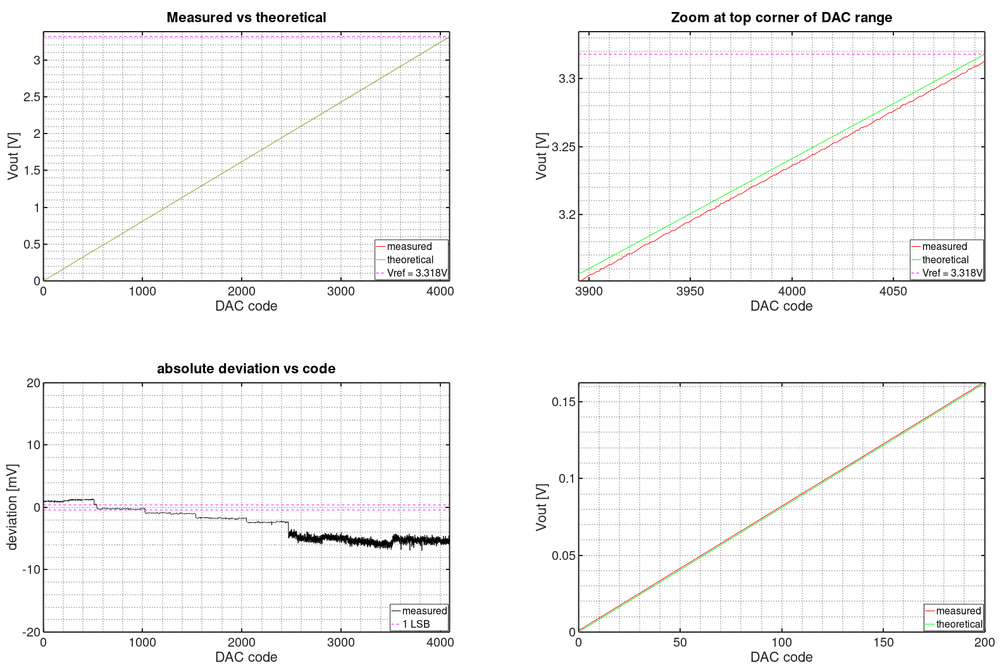

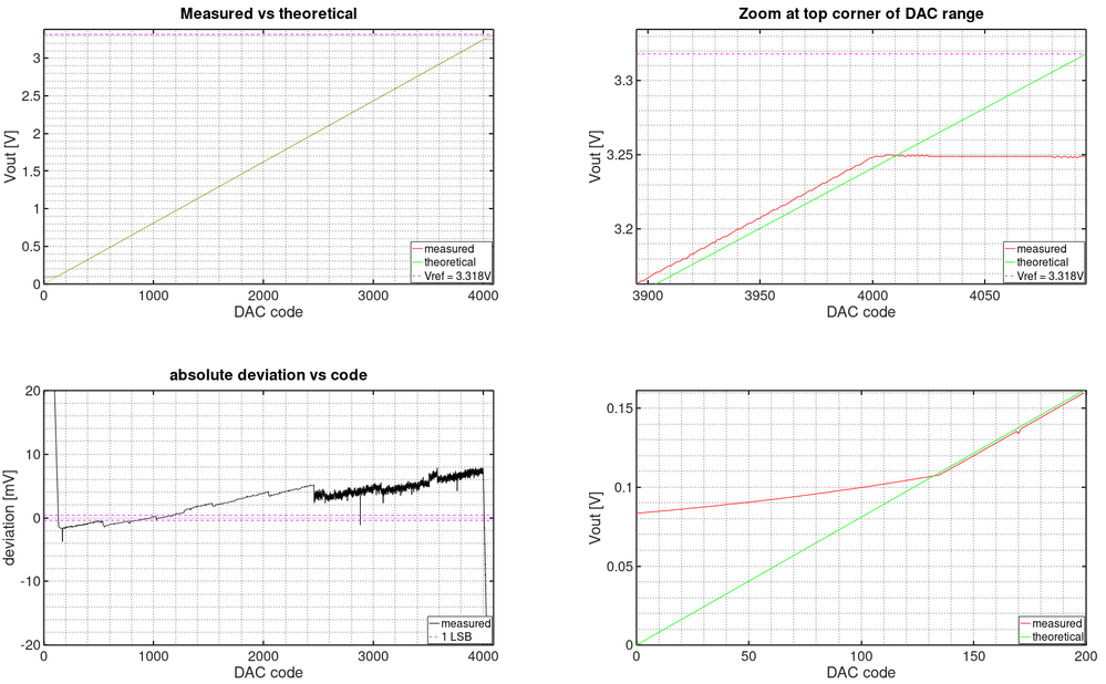

May be it can help you. About a year ago i've tested DAC at STM32F303K8 (Nuclo 32 board) with UT71A multimeter (~0.1%) with these results:
Without output buffer to High impedance (multimeter)
and with (internal) output buffer to 27k/27k divider (VDD/GND)
Measurment takes about 25 minutes (MCU reads data from multimeter by its optocoupled output). In left bottom graph is deviation from ideal state. AVDD was 3.3V (from voltage regulator on Nucleo board). Noise in range over 2V is due multimeter range (switch from 2V to 20V range). Of course i've measured "ramp" signal, but your "tooths" should be visible with amplitude about ~2.4mV. That problem with high probability didnt show up at F303K8. I recommended do measurment against voltmetr.
