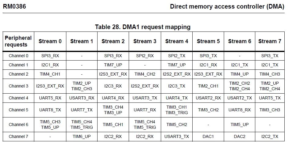

But, first of all, go to DMA chapter in the RM, and check whether TIM6 can trigger the Stream you selected and on the Channel you've set in the stream's configuration register.

The reference manual associates TIM6_UP(DATE) with DMA1 Channel 7 Stream 1, where as DAC1 would be DMA1 Channel 7 Stream 5.
Decide what is driving the DMA, usually you configure the DAC to use a specific periodic trigger, and have the DAC initiate the DMA. You are trying to use the TIM directly, which might well work, but using random resources won't.

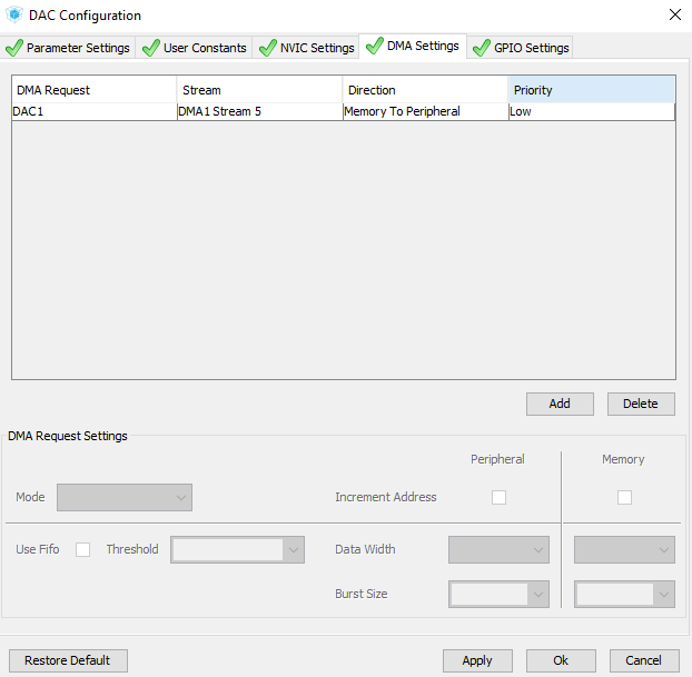

I use the cube for this exact reason..
the cube is suggesting to use a different DMA...

The reference manual, when carefully read, suggests the same.
Only it is two orders of magnitude smaller than an installed Cube ...
