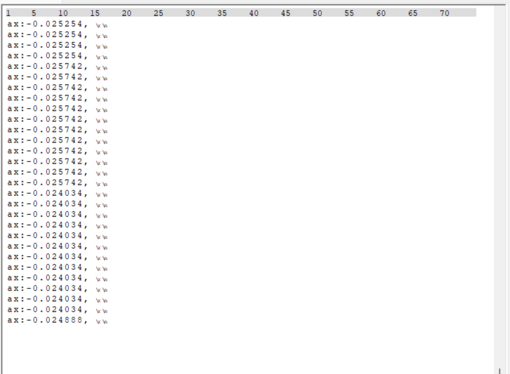

Unfortunately, the data on the M7 side seems to repeat ever so often and I'm not sure why. A sample output is shown below.
I'm not sure if I'm making a very obvious mistake here. I've looked around and tried all sorts of tricks. The only one that seems to have worked is Tijen Majerle's [ring buffer implementation] but this doesn't seem to make use of the HSEM. I'm looking for a HSEM solution partly out of curiosity and partly for performance reasons down the line.
