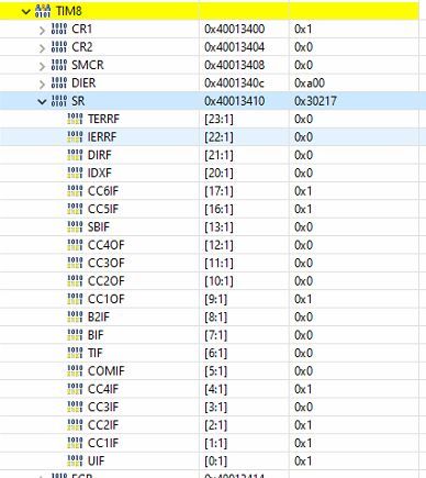

Thanks for the information. By "enable TIM8" I meant TIM8->CR1 |= TIM_CR1_CEN;
If those unused compare flags being set is not a problem then I will ignore them. Attached is a snapshot of the TIM8 SR register while debugging this.
