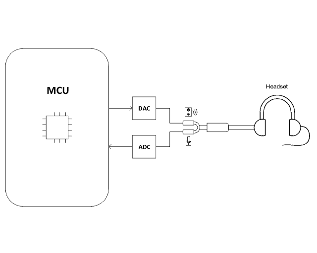

I am trying to figure out how to use the built-in ADC and DAC ports of my Nucleo-F446RE board. My end goal is to record and play a block of sound using the Hal-library. The setup is simple, I want to connect a built-in speaker and microphone of a headset to my board so that I can stream sound from one end to another. The application is useless, just getting started with audio devices and learn how to use the Hal-Library.
With that said, I want to know if I can directly interface the headset pins to my Nucleo board, or I do need a specific circuit, perhaps an amplifier circuit, to do so without damaging any of my devices. It is worth to mention that I don’t have much experience with electronics, so if I do need a such circuitry, please recommend me a link or a part number of a ready to use breakout board that allows me to do so without the need to build it form a scratch.

Yes, you need an amplifier, both for the headphones and for the microphone.
This is not an STM32-specific task and I don't think there are many users here ready to discuss beginner issues. You may want to go to a different forum, e.g. https://www.eevblog.com/forum/beginners/ .

Nucleo boards are not designed for audio application. But there are many ST evaluation boards that support audio, using specific IC - codec. You can even download schematics on the ST product page
