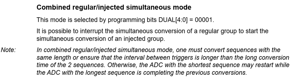

- When in Injected simultaneous mode, regular conversions are possible, but use the settings of the common registers for dual settings?

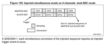

- Picture "say what": It does not really say how it would behave in that case.
- With all the information i gathered, i can not really determine, how the ADC would work in combination with DMA. When i start regular conversions on ADC2, is it then considered dual mode?

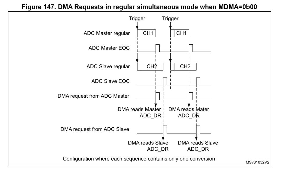

You have posted a picture of the wrong mode. Yes, its confusing sometimes.
