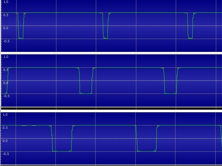

I
want to make a
signal
to drive the
servo
to the
control
signal
high
and signal
low
as
I included
this
, how to makethe signal
,I
can control
with a
logic
high
Thanks clive12011-10-13 10:25 AM
2011-10-13 10:49 AM
Ok, I don't see a horizontal scale, but I'll assume you have a 20 ms period.
With PWM you control the ''width'' of the high portion with the CCR register for the channel. It's referred to as the duty cycle, 10/90 would spend 2 ms high, 18 ms low, using my suggested settings you'd be programming in 1000 into the CCR Again, what is the minimum and maximum width of the high portion? I don't have the specifications for *your* servo.With that information you could convert a fractional angle, 0-360 degrees, into a setting written into the CCR.
Some typical ones rotate 180 degrees and expect a 600 to 2400 us width to achieve that range, ie 1800 us or 900 tick units at 500 KHz (2 us) TIM3->CCR2 = 300 + (u16)(angle * 10.0); // where angle is a float 0.0-180.0 degrees So perhaps something like : void TIM3_IRQHandler(void) { if (TIM_GetITStatus(TIM3, TIM_IT_UP) != RESET) { TIM_ClearITPendingBit(TIM3, TIM_IT_UP); // minimum high of 600 us, with 180 degrees at 2400 us TIM3->CCR2 = 300 + (u16)(angle * 5.0); // where angle is a float 0.0-180.0 degrees } } If I changed scale/period to something like 8/60000 I could achieve even better resolution/granularity. If you have 4 servos, you could use the same TIM3, and all 4 PWM channels. Edit: fixed scaling to 5.02011-10-13 12:34 PM
