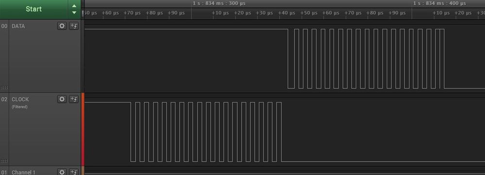

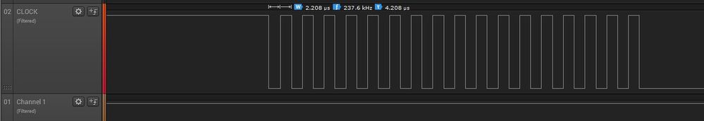

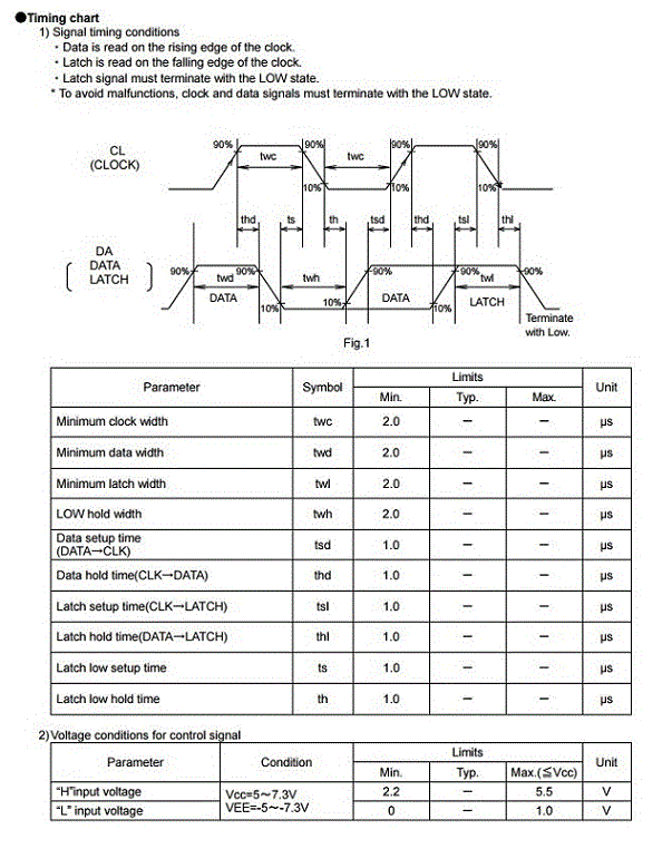

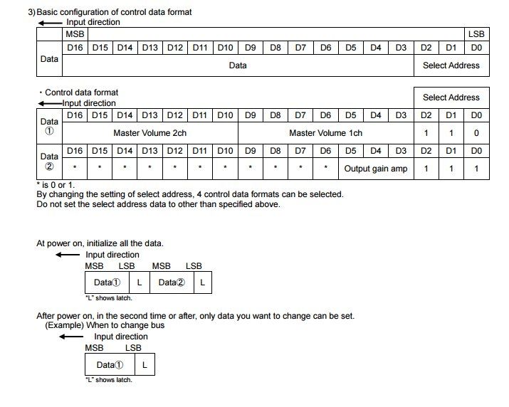

need to implement such a protocol2016-08-02 7:06 PM

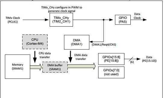

The fact it uses both clock phases, and that the data leads the clock means you need to drive the DMA with one timer channel, and then toggle another channel with delayed phase.
The alternative is to drive the clock as part of the GPIO DMA, at perhaps 4x the bit/clock rate, from a pattern buffer.2016-08-03 3:19 AM
I would use a timer only to generate clocks - one channel in toggle mode for the clock to the device; other in PWM mode to generate a double-frequency clock, which I would then feed externally to SCK of a SPI, which in turn in slave mode would provide the data, feeding itself through DMA.

need ''mask'' clock also - bcs need only 17 clocks for each bit transfer, and with latch no need clock , need drop down line
for example clock mask in bit ''101010101010101010101010101010101010''+''0''latchbitdata any 17 bit ''101010101010101010101010101010101010''+''1''latchbitand clock run after data2016-08-03 5:08 AM

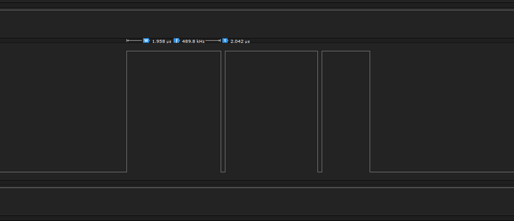

cut task on two part:
1. Make Data signal/* TIM3 init function */
void MX_TIM3_Init(void)
TIM_MasterConfigTypeDef sMasterConfig;
TIM_OC_InitTypeDef sConfigOC;
htim3.Instance = TIM3;
htim3.Init.Prescaler = 0;
htim3.Init.CounterMode = TIM_COUNTERMODE_UP;
htim3.Init.Period = 168;
htim3.Init.ClockDivision = TIM_CLOCKDIVISION_DIV1;
HAL_TIM_PWM_Init(&htim3);
sMasterConfig.MasterOutputTrigger = TIM_TRGO_RESET;
sMasterConfig.MasterSlaveMode = TIM_MASTERSLAVEMODE_ENABLE;
HAL_TIMEx_MasterConfigSynchronization(&htim3, &sMasterConfig);
sConfigOC.OCMode = TIM_OCMODE_PWM1;
sConfigOC.Pulse = 0;
sConfigOC.OCPolarity = TIM_OCPOLARITY_HIGH;
sConfigOC.OCFastMode = TIM_OCFAST_DISABLE;
HAL_TIM_PWM_ConfigChannel(&htim3, &sConfigOC, TIM_CHANNEL_3);
HAL_TIM_MspPostInit(&htim3);
void HAL_TIM_PWM_MspInit(TIM_HandleTypeDef* htim_pwm)
if(htim_pwm->Instance==TIM3)
/* USER CODE BEGIN TIM3_MspInit 0 */
/* USER CODE END TIM3_MspInit 0 */
/* Peripheral clock enable */
__HAL_RCC_TIM3_CLK_ENABLE();
/* Peripheral DMA init*/
hdma_tim3_ch3.Instance = DMA1_Stream7;
hdma_tim3_ch3.Init.Channel = DMA_CHANNEL_5;
hdma_tim3_ch3.Init.Direction = DMA_MEMORY_TO_PERIPH;
hdma_tim3_ch3.Init.PeriphInc = DMA_PINC_DISABLE;
hdma_tim3_ch3.Init.MemInc = DMA_MINC_ENABLE;
hdma_tim3_ch3.Init.PeriphDataAlignment = DMA_PDATAALIGN_WORD;
hdma_tim3_ch3.Init.MemDataAlignment = DMA_MDATAALIGN_WORD;
hdma_tim3_ch3.Init.Mode = DMA_NORMAL;
hdma_tim3_ch3.Init.Priority = DMA_PRIORITY_VERY_HIGH;
hdma_tim3_ch3.Init.FIFOMode = DMA_FIFOMODE_DISABLE;
HAL_DMA_Init(&hdma_tim3_ch3);
__HAL_LINKDMA(htim_pwm,hdma[TIM_DMA_ID_CC3],hdma_tim3_ch3);
/* USER CODE BEGIN TIM3_MspInit 1 */
/* USER CODE END TIM3_MspInit 1 */
run :
uint32_t buf[4] = {84, 84, 84, 0};
HAL_TIM_PWM_Start_DMA(&htim3, TIM_CHANNEL_3, buf, 4);
uint32_t buf[4] = {168, 84, 84, 0};

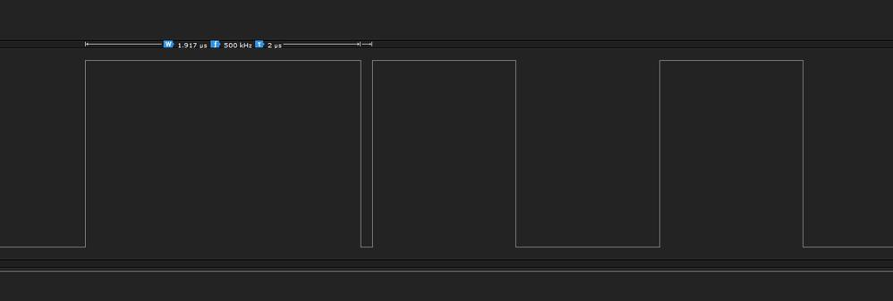

i must see 3usec at HIGH 1usec LOW and 1 usec HIGH but i got :
uint32_t buf[4] = {162, 84, 84, 0};
a got
uint32_t buf[4] = {161, 84, 84, 0};
2016-08-04 4:04 AM

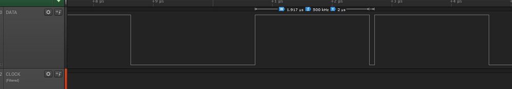

If i run timer in
Output Compare -> mode Toggle on match
uint32_t clk[34] = {167, 0, 167, 0, 167, 0, 167, 0, 167, 0,
167, 0, 167, 169};
HAL_TIM_OC_Start_DMA(&htim3, TIM_CHANNEL_3, clk, 34);
In this mode cant get two HIGH impulses side by side.
But for CLK its OK
uint32_t data[35] = { 161, 0, 161, 0, 161, 0, 161, 0, 161, 0,
161, 0, 161, 161, 0};
HAL_TIM_PWM_Start_DMA(&htim3, TIM_CHANNEL_4, data, 35);
i cant get 100% PWM
(GPIOC->BSRR) but no luck - always get
HAL_DMA_STATE_ERROR.:
uint32_t Length = 34;
htim3.State = HAL_TIM_STATE_BUSY;
htim3.hdma[TIM_DMA_ID_CC3]->XferCpltCallback = TIM_DMADelayPulseCplt;
htim3.hdma[TIM_DMA_ID_CC3]->XferErrorCallback = TIM_DMAError ;
HAL_DMA_Start_IT(htim3.hdma[TIM_DMA_ID_CC3], (uint32_t)pData1, (uint32_t)&(GPIOC->BSRR), Length);
__HAL_TIM_ENABLE_DMA(&htim3, TIM_DMA_CC3);
TIM_CCxChannelCmd(htim3.Instance, TIM_CHANNEL_3, TIM_CCx_ENABLE);
if(IS_TIM_ADVANCED_INSTANCE(htim3.Instance) != RESET)
__HAL_TIM_MOE_ENABLE(&htim3);
__HAL_TIM_ENABLE(&htim3);
Also have questions about synchronizing Channels in Timer.
I think its not possible? Need devide CLK and Data to separate timers, one in master and CLK in slave mode? Or use third Timer to run this both?
How make delay between CLK and Data?
2016-08-05 3:13 PM
Use a timer with multiple OC channels - you must use TIM1 or TIM8 anyway, because of the DMA issue that I've already mentioned. Do not try to use the timer to directly drive the clock signal.
e.g. If TIM1 is clocked at 100MHz, and you want to work at the maximum bus frequency of 250kHz, set PSC = 0, ARR = 400, CCR1 = 100, CCR2 = 200, CCR3 = 300. For each transmission, construct an array of data and latch bits. The last latch bit must be '0' and I presume that the others must be all '1'. Data: 0b10101010101011 Latch: 0b11111111111110 Configure the TIM and DMA to: Write your data pin to the next data bit value on TIMx update trigger. Write your clock pin to '1' on TIMx->CH1 trigger. Write your data pin to the next latch bit value on TIMx->CH2 trigger Write your clock pin to '0' on TIMx->CH3 trigger Use bitbanding to target the DMA transfers at particular bits in the data and latch arrays, and the GPIO ports.We’re moving the ST Community to a new platform to give you a better and more reliable community experience.
