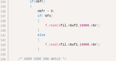

Complaint about writing, but shows reading code. Should I learn something from that? Does that work?
Bunch of variables which should be volatile to work properly.
Use a multiple of 512 bytes for buffer lengths, otherwise a lot unnecessary card accesses.
What exactly is working or not? How is it failing vs expectations?

I think I fixed that but now the ide is giving me a headache, shows a bunch of errors, I am gonna share my code after my changes(in cubemx) once I turn on my laptop
2025-02-01 11:53 PM
Here it was working before it started throwing errors and above is the console output

2025-02-02 1:55 AM
-> missing "}" from
if(nbfr)
