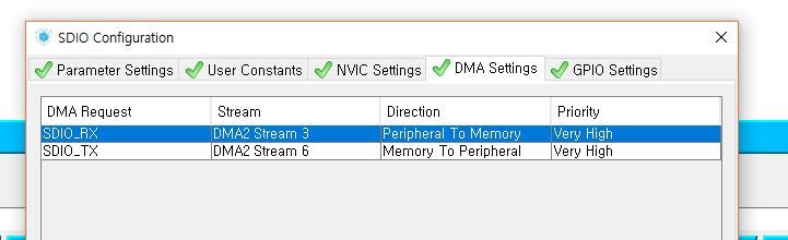

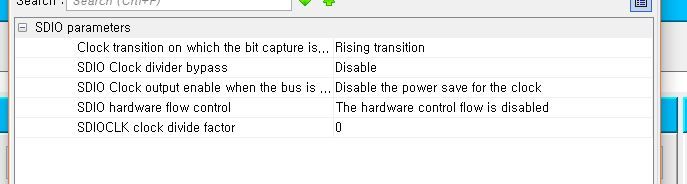

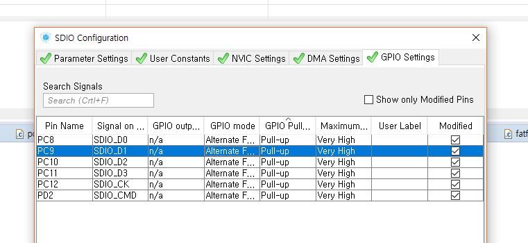

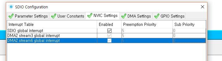

Hi.
At the first time, SDIO works well but 10~20 minutes later, when i try to open a file(FA_CREATE_NEW | FA_WRITE options), there is no answer for 30 seconds and then SDIO does not work anymore after being shown FR_DISK_ERR.
Through debugging, I found that SDIO doesn't work as soon as the osMessageGet called on SD-Write function (osMessageGet result is osEventTimeout).
This problem disappears when the SDIO clock speed is lowered (ClockDiv is 8 or more). However, the Read/Write speed get very slow too much than i want.
STM32F429 use
CubeMX 4.25.0
STM32CubeF4 Firmware Package v1.21.0
FreeRTOS 9.0.0 (CMSIS 1.02)
FatFS R0.12c
SDIO Settings (DMA used)

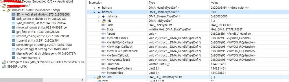

As your say, i tried to reconnect as soon as i faced FR_DISK_ERR but HAL_SD_ERROR_TIMEOUT was happened in SD_FindSCR.
I'm sorry but i can't understand why i faced the problem when i try to write some data. There is no any problem while i read the file about 10 minutes.
Because i didn't find any problem while i have used STM32f103 (Used HAL, didn't use FreeRTOS that time), i have no idea about the way what i should do for test.
Another question, I found the SD Read/Write speed is too slower than Std libray (No use DMA) even though i use HAL driver (use DMA).
I'm afraid that i did wrong set with Peripheral or there is any problem with the way i use it. I'm using the default code generated by CubeMX.
It would be very appericiate it, if you would let me know what i have to pay attention to set SDIO, FreeRTOS and FatFS.
Thank you so much for your help.
About 5~ minutes later SDIO_IRQHandler is called although i do not use SDIO. And i found that HSD state is changed as above.
