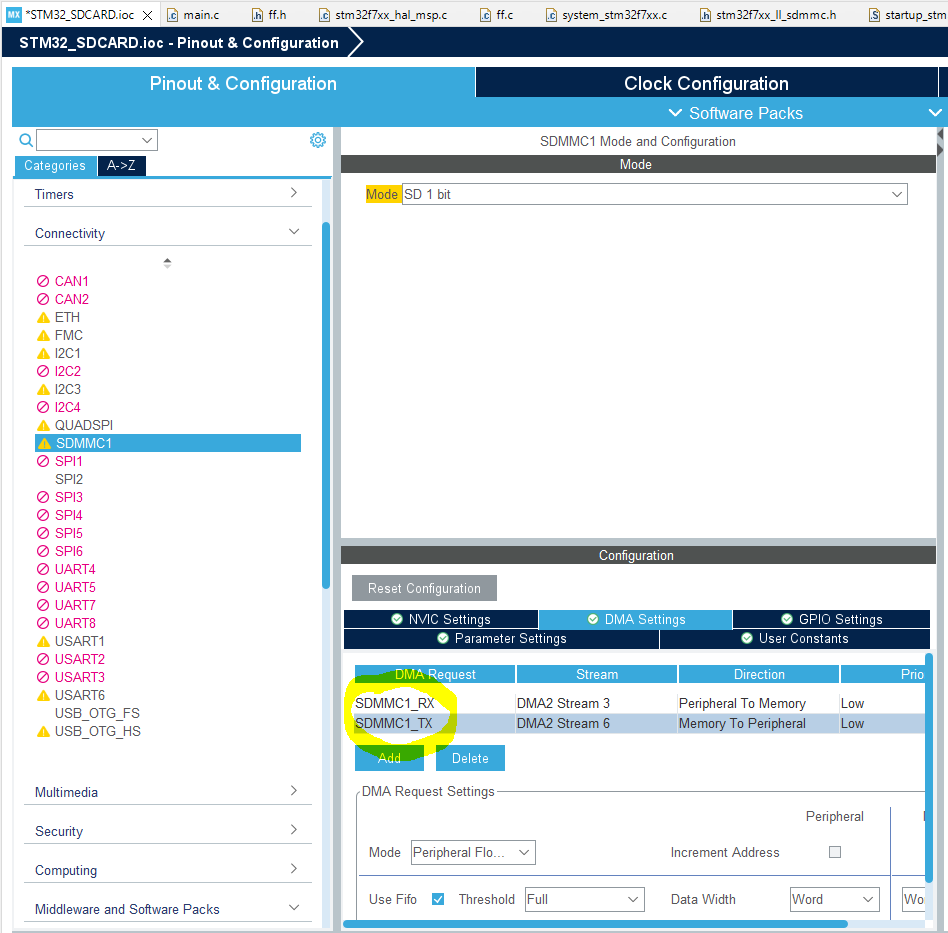

I managed to get it working
I watched the video of the same guide and noticed the video has an extra step to add the DMA request for RX and TX...
Since doing that the code now writes to both SD cards BUT only when the SD mode is 1 bit.
It does not work when the SD mode is 4 bit.
I did try manually changing to 1 bit by setting...
hsd1.Init.BusWide = SDMMC_BUS_WIDE_1B;But this did not seem to work.
It only started working after I added the DMA requests as shown in the video, but not the written guide.
So the error is the missing step in the guide then ?
I assume SD mode 4 bit wide would be faster than 1 bit ? In which case, how do I get 4 bit wide mode working ?

About DMA : i had it always without dma (in fatfs : dma template off) , so the dma setting should be not important for working or not. (No dma: because i anyway wait for the data on a read etc , so no sense to make it more complicated.)
SD mode 4 bit wide is faster , but if you dont need maximum speed, why make it more complicated. :)
But try - it should work now, just set it in Cube. (+ check: its connected 4bit on your board !!!)
+ First set correct speed for sdio: i use 100MHz , and clkdiv 1 in sdio parameter (in Cube) , = 50M for card.
