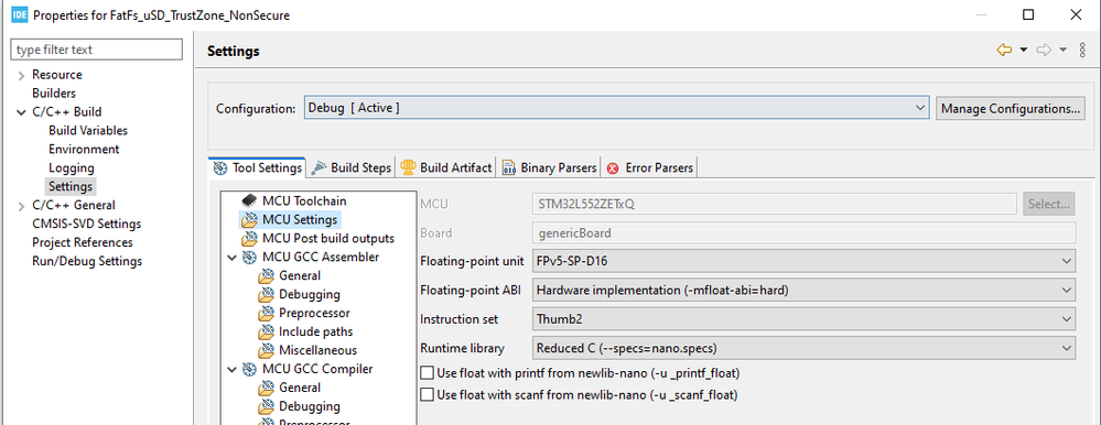

2024-01-18 9:11 AM
Thanks SofLit, I tried to use one of the FatFs_uSD_Standalone examples but it would not run because it was using the wrong processor and I don't know how to change it to a STM32L433.
The settings for MCU in the project properties are greyed out and cannot be changed...
2024-01-18 9:21 AM - edited 2024-01-18 9:22 AM
You need to start from scratch using CubeMx to initialize the needed peripherals mainly the SDIO + Adding FatFs and populate your project by inspiring from the example.

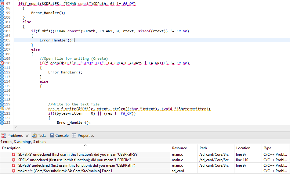

2024-01-19 6:13 AM
Thanks SofLit, I followed the youtube video but get the following build errors...
The only difference between the youtube video and my project is that I am using the NUCLEO-L433RC-P (whereas the video is using the STM32F746G-DISCO).
