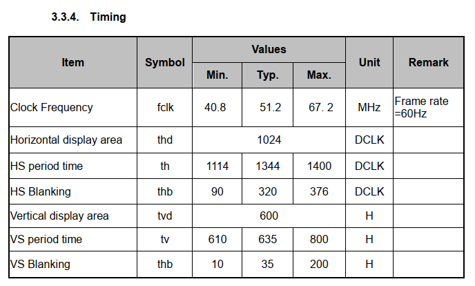

1. TFT-LCD (JWS070NA-23A-1)

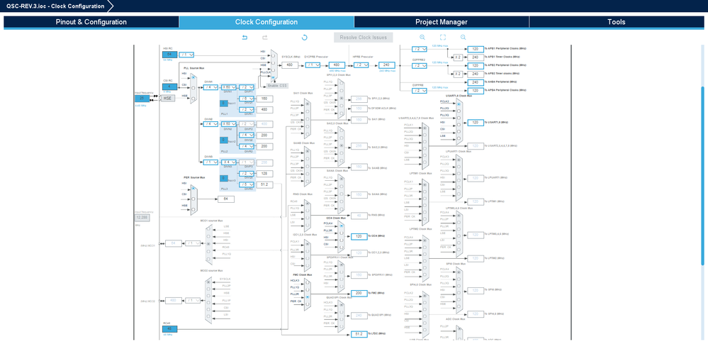

3. Clock configuration

/* Polarity configuration */
/* Initialize the horizontal synchronization polarity as active low */
hltdc.Init.HSPolarity = LTDC_HSPOLARITY_AH;
/* Initialize the vertical synchronization polarity as active low */
hltdc.Init.VSPolarity = LTDC_VSPOLARITY_AH;
/* Initialize the data enable polarity as active low */
hltdc.Init.DEPolarity = LTDC_DEPOLARITY_AL;
/* Initialize the pixel clock polarity as input pixel clock */
hltdc.Init.PCPolarity = LTDC_PCPOLARITY_IPC;
// for some reason the display content is shifted.... ??? msy
#define SHIFT 1
/* Timing configuration for LCD */
/* Horizontal synchronization width = Hsync - 1 */
hltdc.Init.HorizontalSync = 108 - SHIFT;
/* Vertical synchronization height = Vsync - 1 */
hltdc.Init.VerticalSync = 13 - SHIFT;
/* Accumulated horizontal back porch = Hsync + HBP - 1 */
hltdc.Init.AccumulatedHBP = 108 + 106 - SHIFT;
/* Accumulated vertical back porch = Vsync + VBP - 1 */
hltdc.Init.AccumulatedVBP = 13 + 11 - SHIFT;
/* Accumulated active width = Hsync + HBP + Active Width - 1 */
hltdc.Init.AccumulatedActiveW = 108 + 106 + 1024 - SHIFT;
/* Accumulated active height = Vsync + VBP + Active Height - 1 */
hltdc.Init.AccumulatedActiveH = 13 + 11 + 600 - SHIFT;
/* Total width = Hsync + HBP + Active Width + HFP - 1 */
hltdc.Init.TotalWidth = 108 + 106 + 1024 + 106 - SHIFT;
/* Total height = Vsync + VBP + Active Height + VFP - 1 */
hltdc.Init.TotalHeigh = 13 + 11 + 600 + 11 - SHIFT;

3) to reduce pixel clock from 51MHz to 40MHz or less to see what happens .
