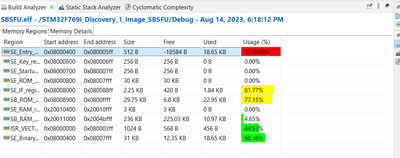

Thanks! I didn't solve the issue but did help finding this out:
That's the information from built in build analyzer for SBSFU.elf. I have no clue why SE_Entry_Secure_ROM_Region is that huge occupying 3729% of allocated memory.

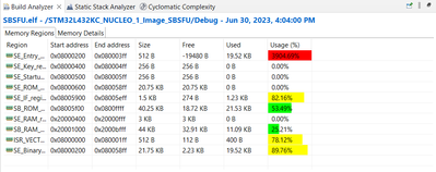

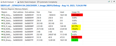

2023-08-15 4:07 AM - edited 2023-08-15 4:15 AM
Okay, so that's weird, but I built two different sample projects:
Both presents same misleading information that there is some issue with memory mapping. The thing is that NUCLEO-L432KC works totally fine. Looks like it's not an issue with the build itself, but with the tool or naming used throughout linker files. Correct me if I'm wrong.
