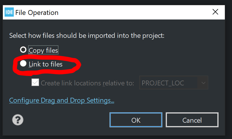

You can add source or header files as linked files and they will be included in the project. Drag and drop will let you do this.

@TDK
what do you mean by linked file?

2022-01-29 7:32 AM
As I said, drag and drop, choose linked.
2022-01-29 9:16 AM
it's enormous, thnaks !
I have yet to see how I can handle all of this (versions in the code base???) but it's a simple way to have that code base.
