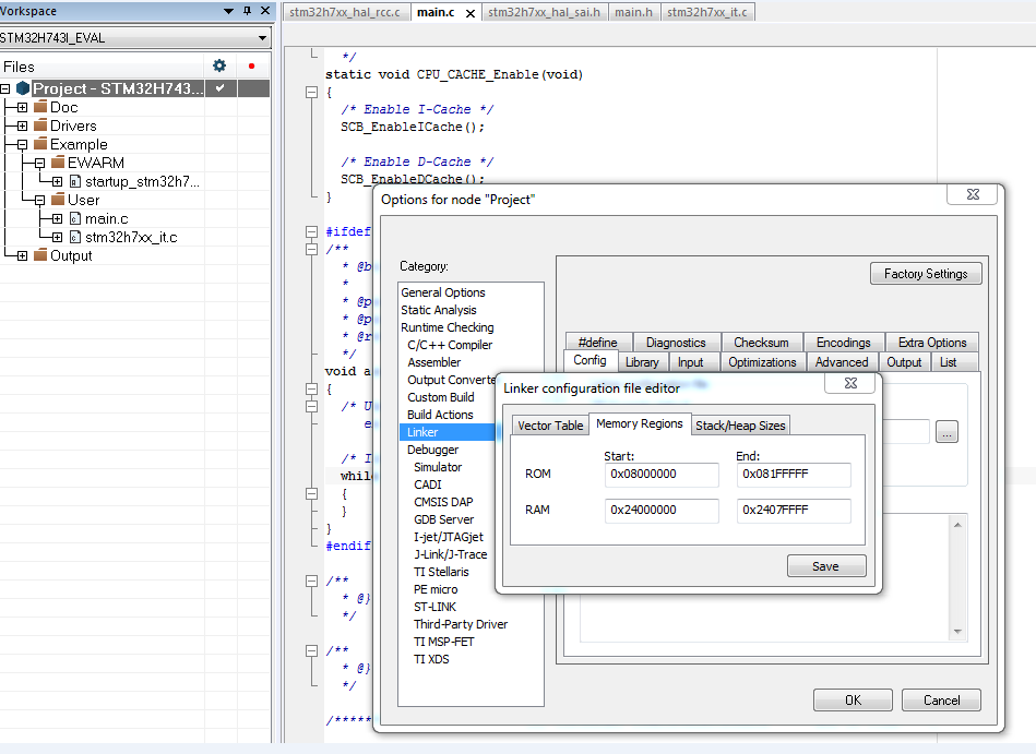

Thanks for the suggestion, As per your suggestion I have done fallowing changes, I am now clearing only Tx & Rx descriptor locations only , But still the issue remain unresolved. Can you please confirm whether I am doing an wrong.
// /* Clean and Invalidate data cache */
// SCB_CleanInvalidateDCache(); /* Invalidate data cache for ETH Rx Buffers */ SCB_InvalidateDCache_by_Addr((uint32_t *)Txbuffer, (ETH_TX_DESC_CNT*ETH_MAX_PACKET_SIZE));// /* Clean and Invalidate data cache */
// SCB_CleanInvalidateDCache(); /* Invalidate data cache for ETH Rx Buffers */ SCB_InvalidateDCache_by_Addr((uint32_t *)Rx_Buff, (ETH_RX_DESC_CNT*ETH_MAX_PACKET_SIZE));Thank you.,
