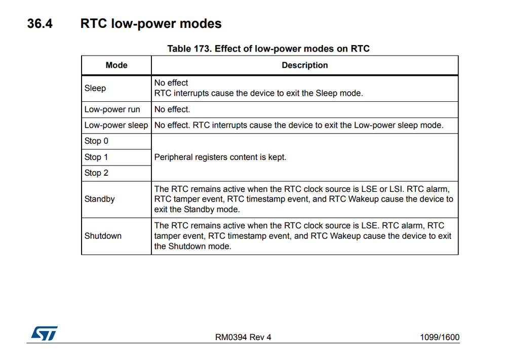

is_stay_in_sleep_mode variable is volatile ?
And check if wakeup is designed or setup for wake from sleep. Normal usage is wake from standby...

Also update on behaviour.
When the wake up interrupt is generated, system does not leave __WFI() instruction.
But when interrupt from UART comes, then it moves out form ISR instruction, and on the next wake up interrupt it starts working as it should.
