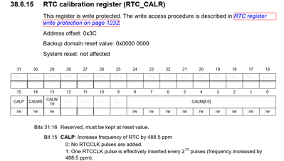

If you want "tune" the rtc, use :

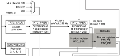

RTC does not work with "milliseconds", the "shift" feature works with the subseconds counter i.e. it "shifts" time by number of ticks (periods) of the asynchronous prescaler's output.
After setting RTC_SHIFTR, you are supposed to check RTC_ISR.SHPF to find out, whether the "shift" has been accomplished. Also, you are supposed to check RTC_ISR.RSF before reading the RTC calendar registers.
Note, that "adding" time involves setting RTC_SHIFTR.ADD1S bit, which advances time by one second. If you want to advance by less than that, combine appropriately ADD1S and SUBFS fields.
Also make sure, you have enabled backup domain access by setting PWR_CR1.DBP.
Read RTC synchronization subchapter of RTC chapter in RM, and description of RTC_SHIFTR register at the end of the chapter.
