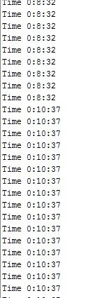

Now RTC is running on LSI Clock and i'm transmitting data via UART2 but the RTC is not displaying updated values but while on reset it is showing updated values as shown in below image.
Thanks & Regards,
Vijay Rakesh.

I have completely same problem with F745 both with internal and external crystal. In addition only SubSecond increase correctly.
Edit: Solve it. just read time AFTER "reading date". you can't read only time, interesting. Maybe someone explain this why.
