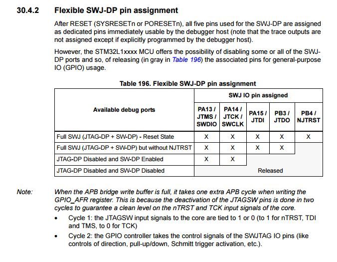

I am trying to configure PB3 (JTDO) as an output GPIO, however I am not able to do so. The pin is always stuck at 1.471V (Vcc/2) Vcc= 2.95.I removed SB101 the solder bridge which connected it to the ST-Link in an attempt to resolve the issue with no luck.PB4 (NJTRST) is having a similar issue, however when a Bit_Reset is written to it by user it resets from ist original state (Pulled up - 2.9V)RM0038 mentions''For user software designs, note that:To release the debug pins, remember that they will first be configured wither in input-pull-up
(nTRST, TMS, TDI) or pull-down (TCK) or output tristate(TDO) for a certain duration after reset
until the instant when the user software releases the pins.
When debug pins (JTAG or SW or TRACE) are mapped, changing the corresponding IO pin
configuration in the IOPORT controller has no effect.''How do I release these pins, PB3 and PB4. Couldn't find any example code or proper explanation. Any suggestions welcome! #!stm32 #stm32l152 #stm32l-jtag-swd-gpio-reuse

quote:32.4.4 Using serial wire and releasing the unused debug pins as GPIOsTo use the serial wire DP to release some GPIOs, the user software must change the GPIO (PA15, PB3 and PB4) configuration mode in the GPIO_MODER register. This releases PA15, PB3 and PB4 which now become available as GPIOs.2016-09-08 12:52 AM

1. you have to change your debug-settings from JTAG to SWD. if you change mode pins will debugging with JTAG your debug-session is likely to crash.
2. change to the desired mode, e.g. output-pushpull with HAL_GPIO_Init()3. set the pin when in output to desired level, e.g. HAL_GPIO_WritePin( , GPIO_PIN_RESET)4. check your hardware / schematic if you have some connected components on this pin/net which mess up your voltage-level2016-09-11 4:18 PM
