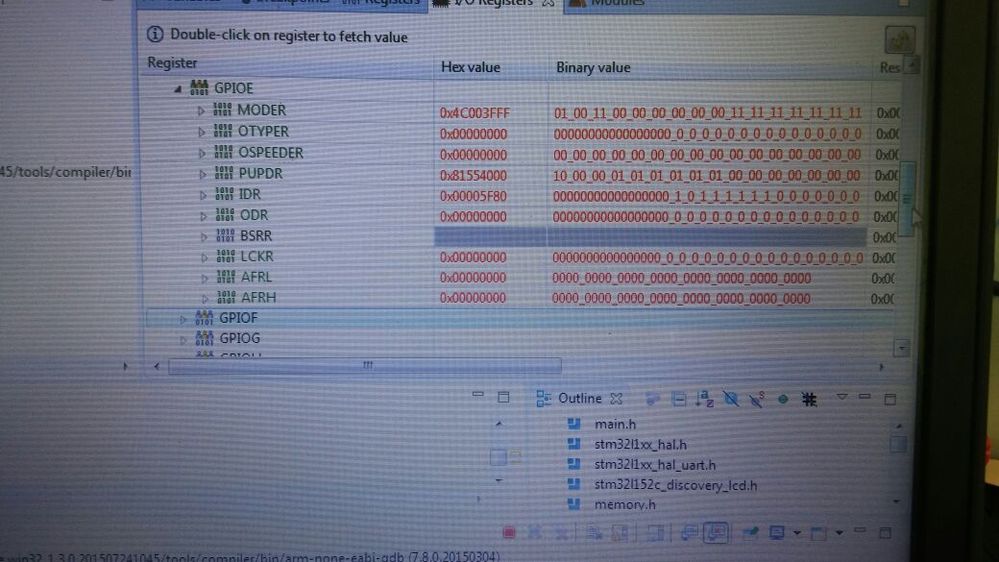

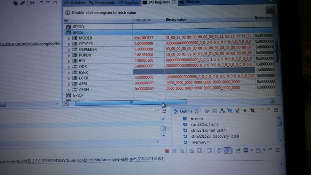

If it is possible to run the debugger, stop the code when anomany occurs and inspect the GPIO register settings
-Attaching the gpio register values for both working and non working conditions
Working fine:
Fault occured:
